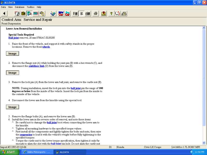

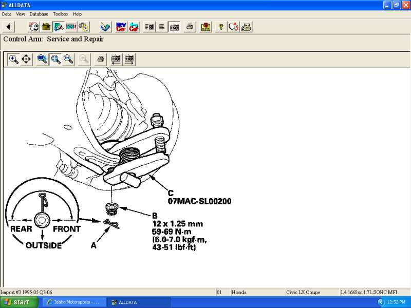

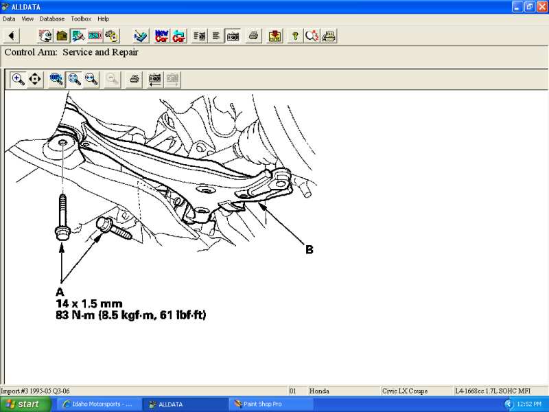

here ya go.....
ID:	72985   Click image for larger version
ID:	72986   Click image for larger version
ID:	72987   Click image for larger version
ID:	72988   Click image for larger version
