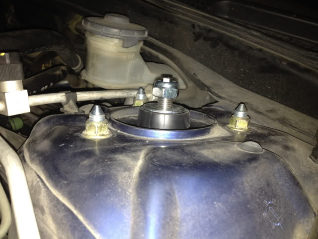

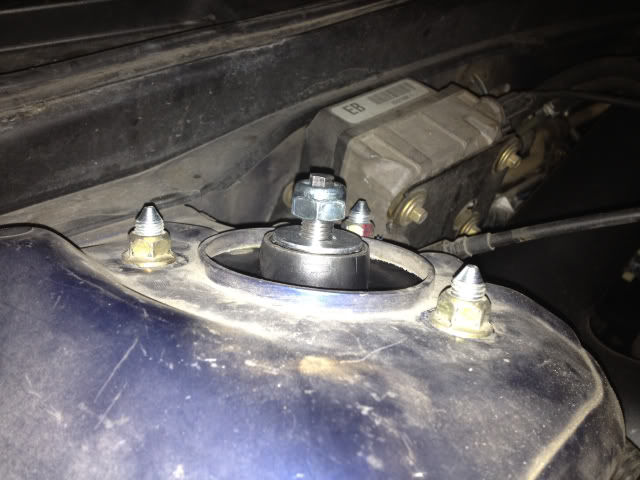

Today I was working on installing my progress coilovers. Everything was going well and when I went to torque down the upper strut bolt. The one in the middle to its spec I couldn't get it to tighten any at all. There's a huge gap between the bolt and the top of the coilover. Here I have attached pics. I followed the directions they gave me and everything seemed perfect when I was installing it. Has anyone seen anything like this when they did their coilovers?
Here are some pics.*

Passenger side

Drivers side

Use a socket and ratchet to hold the shaft still, and use a wrench to tighten the nut.
The nut is a locknut, so it probably has a nylon insert...it will be tight all the way down.
Or get a 1/2" drive impact gun and see if the nut will zip down.

your strut is spinning with the nut. you have to hold it still while tightening the nut. impact guns work well because they spin faster than the strut. when it gets to a certian point you can just crank it down

Very nice. Worked perfect. But now I can't get the rears in. The bottom hole here the single bolt goes in through the strut wont go in. I've tried everything to get it in and nothing. So I'm taking it to work today to grid it down a little and hopefully that'll help.

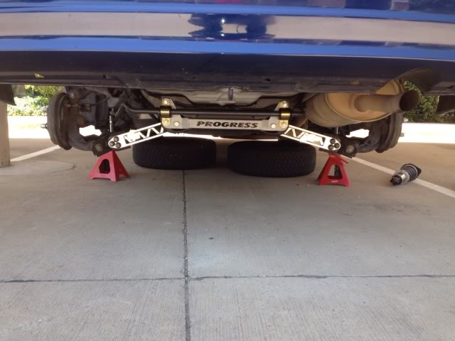

Here's a teaser shot of what I have done so far. Just missing my rear struts and progress front sway bar.

Im jealous...what size is the rear sway?

It's the progress 22mm rear sway bar. I also have the progress 27mm front sway. Just waiting on new end links to come in

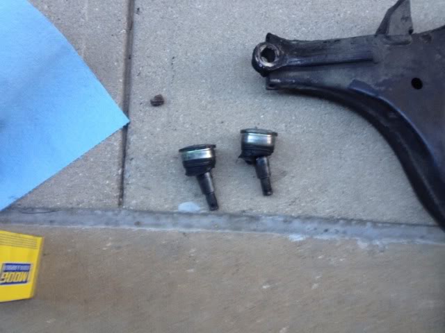

Anyways I have another question if anyone could help me out. So after I did everything I moved onto removing my front lca do I can put in my ES bushings in and while trying to remove the ball joint using every trick I could find and not able to get it out I tore up my ball joint. Now I have to replace my ball joint idk how I'm going to get it out so hopefully I can figure something out.

efff you and efff you
