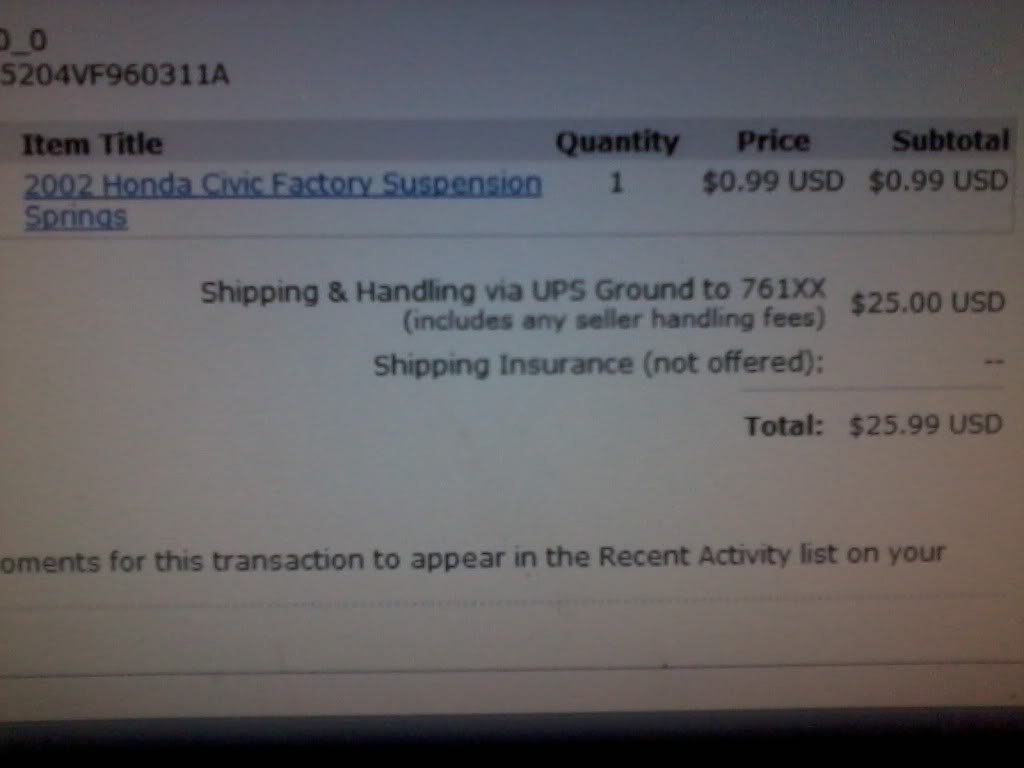

Man, day late and a dollar short. Wish I had seen this thread sooner. There's like 8 sets of springs on local CL. OEM and aftermarket, all for $40-80.
Just so I can rub it in:
Everybody recognize a Paypal receipt? Ebay find, I was the only bidder. That was in early '09, need new springs already. Stupid potholes!

That's what I was thinking, but I noticed all the springs are black which led me to believe they are the pro-kit. The new spring has settled to almost match the other 3. But I'm still kinda set on just putting the new ones in. The guy here doesn't really want to do the work because he is saying there will be no difference between the new and old springs.
I want to have him just do it anyway because they are new, am I crazy?
Old Apr 29, 2011
lazlong's Avatar
Joined: May 2010
Posts: 3,662
From: Funkytown, Tx
Rep Power: 236
Re: My car is lowered on one side :'(
Originally Posted by thefatalepic
...am I crazy?
Probably but, make him put the new ones on. You don't know how old they are. Then post 'em on local CL. You won't get much but, it'll be something.
Old Apr 29, 2011
thefatalepic's Avatar
Joined: Feb 2011
Posts: 180
From: Los Angeles, CA, USA
thefatalepic is an unknown quantity at this point
...The guy here doesn't really want to do the work because he is saying there will be no difference between the new and old springs.
Hahaha XD. Nice response. Lol.. Thanks, I'll have them do it. I just wanted some confirmation that I'm not the only one thinking I should might as well put the new springs in.
