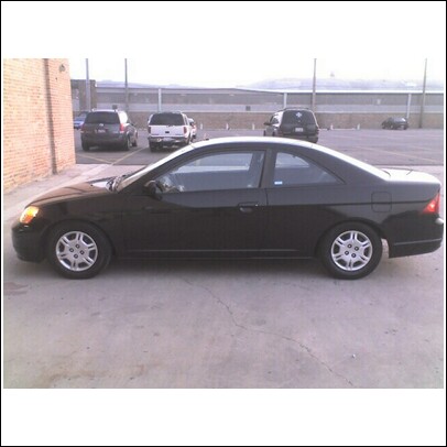

Finally got a pic..

buy camber kit, some 16s, lip kit and then slam that bish!
good start tho
