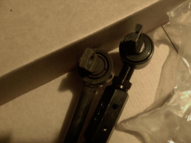

Does your alignment shop sell tires too? lol. I just put on one of my SPC rear camber kits on ( ran out of daylight) an I see this beefy bushing on it where it bolts to the body. On the stock arm...I see NOTHING filling in the sides and some crumbling thin hard thing I think used to be rubber...wonder if having that would contribute my rear kicking to and fro over bumps.

Re: fyi-rear suspension squeak
pics!!!, but from the description, id say probably

I went to take pictures but I left my USB cable at my job apparently. Doh!! lemme try and take one and send it to my email then ill grab it and post the comparison

lol I just emailed this to my job and remote desktoped into the office to do this. Left is stock, right is my new SPC camber kit.

yea, that could contribute, but the oem doesnt seem to be tooo bad, its dry rotted and cracked from what i can tell, rubber sucks, spc comes with polyurethane which is much sturdier and long lasting, i bought ingalls, which can come with either, and im having to replace them after only a year(only a 90 day warranty), but short answer, replace them and see if it goes away, if its crumbling and cracking, then yes, that was ur problem(i know, obvious right) bad bushings suck

alex w, i would not drill a grease fitting there since its a control arm and there is quite a bit of torque on it during cornering and strut compression, so i would advise against it, pretty much ur only permanent fix is to get an spc with polyurethane bushings
