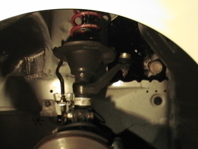

alright i took this with my phone... this is the front right GC installed
when this is off the jack this is about a 7finger wheel gap..

mine does not look like that. my sleeves are over the strut(my shocks are in my sleeves ). it should look like this

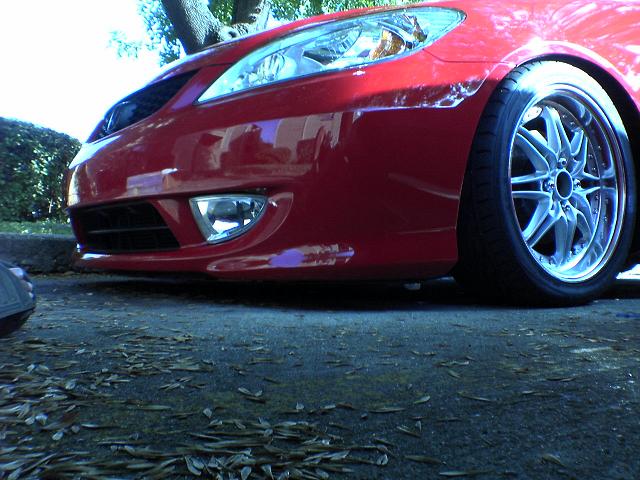

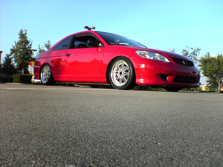

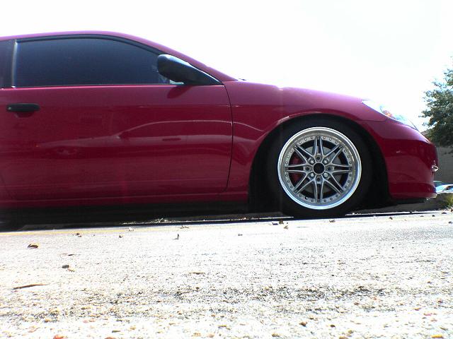

thats wrong check mine...i drop it 4"....and 2" from the ground

so my problem is that the sleeves arent not wide enough to fit around the btm portion of the strut? does that mean Ground Control did not send me the right sleeves or do i have to buy a smaller strut? are your struts stock or aftermarket?

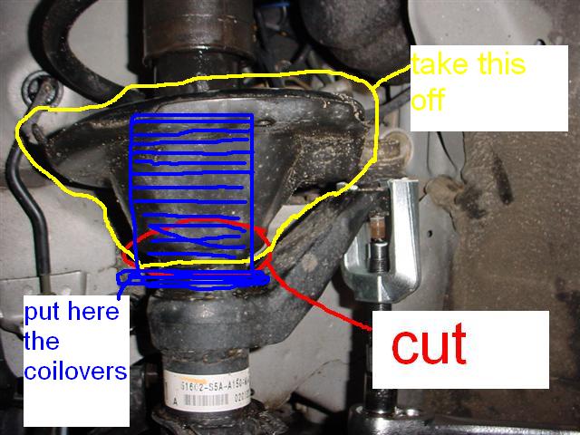

bhoy what am i supposed to cut when i take that strut seat off?

you dont have to cut the seats(though it would be easier to adjust by cutting part of the seat) i dunno why it does not fit. maybe they sent you the wrong sleeves?

They put the fronts on the rear and the rears on the front. Get your money back, take it somewhere where the people working on it know what theyre doing

Boilermaker IS right. The short collars go in the rear. The other dead give away is the tapered coil. The front springs are straight. The rears taper in because of the smaller seat diameter in the rear. So like I said, idiots did the work for you, get your money back, take it to your own driveway and fix it. If not, make sure they fix their **** up for free (and a free alignment for the inconvience).
