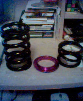

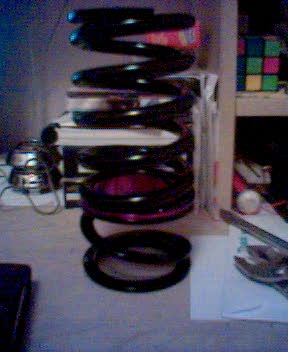

This is what i got in the mail today
The springs were Clearly labeled EP3 Rear. So im sure they are okay to use with the civic.
Im assuming i put it on the shock with the smaller spring on the bottom and the taller spring up top, seperated by the purple metal seperator.
Is this some kind of new design? Is this an improvement? It reminds me of the B&G coilover Dual SPring design. The original D2 rears didn't come with this kind of spring.
*Im SURE these new springs will resolve the height issue that some of us D2 owners had with the rear springs being too tall. These new springs are definitly shorter. I just hope it rides just as good!

yeah, i just go mine today. are you sure that the springs will solve the height issue? it looks like the two springs equal the length of the old springs. by the way, when are you installing them?

yea im sure, the small helper spring isnt really that strong. It will compress a significant amount. i guess it lessins the preload on the springs?

are the two springs a better design??? if so i feel a little ripped, i have the 10k springs in the rear and they are almost all the way down but i still have about three fingers gap.

As far as I'm aware 8k is the only rate D2 has implemented the helper spring on. I don't think there is any advantage to the helper spring.

so, to get this straight...the NEW larger of the two springs goes on the bottom, then the purple separator, then the NEW smaller of the two springs?? also, i thought the EP3 springs had a different spring rate than the ES1/EM2??

Yeah the helper spring doesnt really effect the ride height much, It is only really there to keep the spring in place so that it doesnt fall off when you jack up the car.
That makes absolute sense! haha. Since the 8K spring is short, it wont dangle when the car is jacked up or when the car hits bumps.

so can anyone confirm that these are the correct spring rates? the new springs were labled "EP3 rear"...and EP3 has higher spring rates than EM2/ES1

slightly higher, maybe by 1k or 2k at the most? it shouldnt really be that big of a difference.

Yea mines are in now. The height issue is totally fixed. With the locks all the way down. im extremely tucking the rear tires. You cannot see the top half of the tire.
*tip: raise your car to the hieght yuo want it before you put it all back on the car. its hard as **** to turn the lock nuts. I turned the rears up 3 threads each and stopped becuase i was exhuasted.
