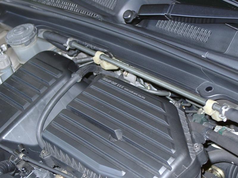

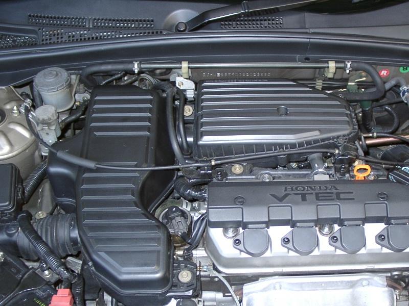

Okay here are the pictures. Notice the pipe running parallel to the firewall. This is the pipe I was referring too which migh interfere with the Neuspeed Strut Bar. Anyone fitted it with this pipe ?
