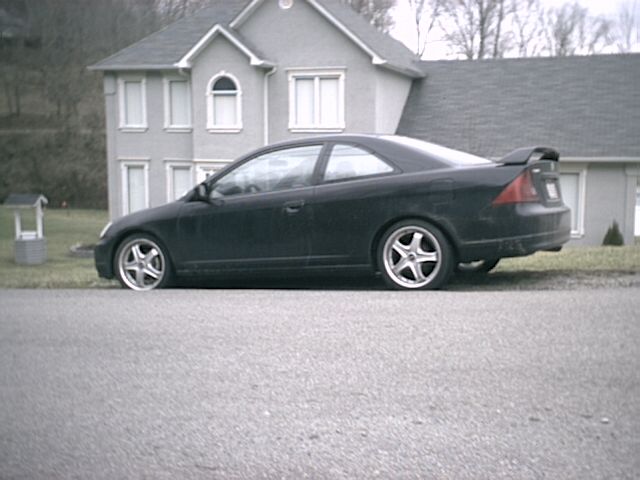

i have Eibach Sportline, 2" front drop, 2 1/4" back.. on 17's, haven't rubbed once. more of a smooth ride than on stock springs. i love em, wouldn't trade em for anything! i got mine at $270 installed.. but i work for the place.. so i'd guess probably $350 or so to have it done. but i'd definately recommend Eibach.. no cheap crap.

Cocky's Avatar
Cocky guys kick ass!
Posts: 3,038
Rep Power: 312
on a slant, but gives ya an idea i guess..
