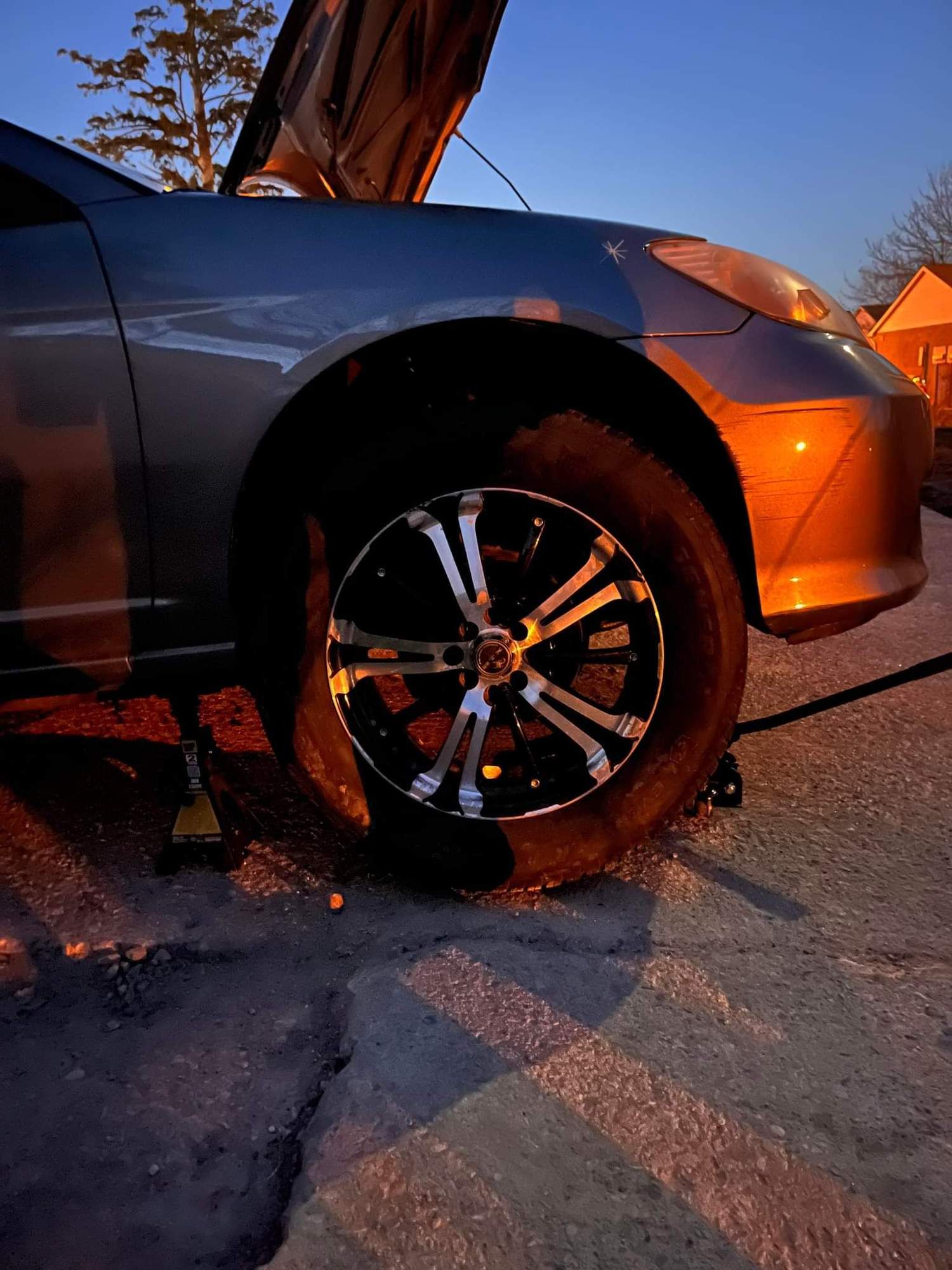

So long story short I am a just getting into the honda civic scene and bought a 05 LX Coupe around a month later I managed to pick up a set of RTX Arsenic's which are 17x7 which happen to also have 225/65r17 tires on them for 450 including mounting and balancing and wanna know the best plan of attack to get them to fit I know the fenders may need rolling but my current issue is clearing the Shock in the front haven't had a chance to try the back yet any and all help would be appreciated and yes I'm well aware my 7th Gen will look like a damn monster truck

+40mm offset there 17x7 they fit in the wheel wells perfect but they are touching the shockz in the front without being bolted on haven't had a chance to try the back yet my theory is spacers

Yep I know how the GIGANTIC spring thats stopping me from bolting them on to asses further what needs to be done works im not some dumb kid ya know lol ive worked on vehicles since I was a small child im now 20 years old and have already realized that besides the spacers I need to negatively offset the rims due to the 42mm of positive offset they come with how about you do some research before you commenced the typing of your next comment im well aware the fenders will either need trimming or rolling both of which I'm capable of doing so please explain further how the rims and tires I had on the lugstuds on not only one but both sides of the front of my car while it raised by Jack stands won't fit my car

suspension moves. it compresses. front wheels need to turn.
rear is even tighter.
picture makes it even clearer that it don't fit
remove springs, push the tire up to see when it starts interfering with other things,, check how much stroke is left to see how hard it will bang when you hit a bump. turn the wheel to see where it will hit.
you nare gonna need to gut way more than the fenders, front and rear.

to those wondering why we say this is not going to work without major gutting?
This case involves the width (known, see above post) but also the tire OD, which is even bigger change.
when suspension compresses, the tire will simply smash through the plastic wheel well and go smash right into the metal chassis above. There will be no gap. See pic below
options?
  • lift suspension - but there are no known makers for lifted civics
  • cut off the chassis - will weaken the upper chassis where the suspension mounts are - ill advised.

add that to interference when turning a wider, taller tire. Wheel well, suspension parts, chassis
I could not find a cut off rear quarter pic of a 7th gen, but same metal obstacles are under the rear quarter.
