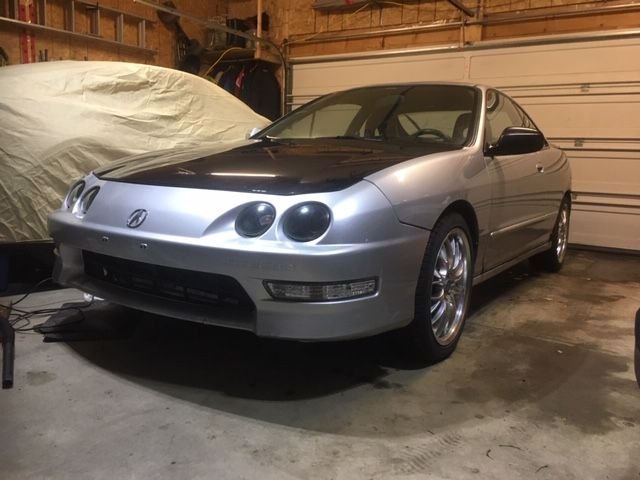

This was the setup on my integra. Same tires (205/45R17), and both sets of rims were 17x8. Never did any suspension work to either car. Very similar cars dimensionally so it'll still give you a decent idea of what they'd look like.
