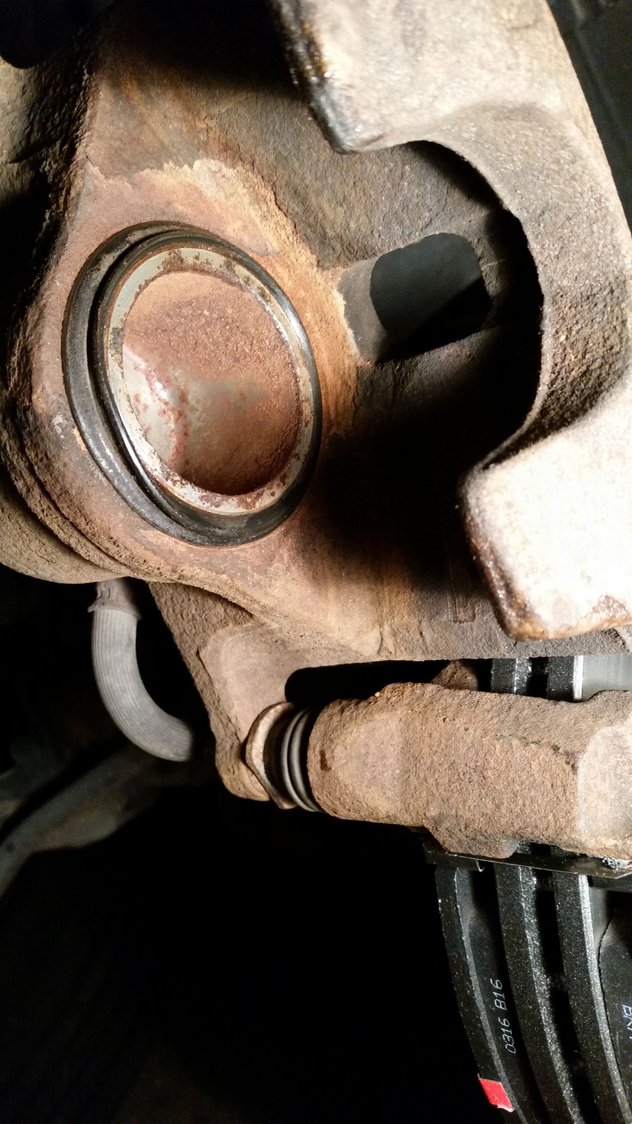

I'm doing the brakes on my 2004 Civic LX. It's my first time doing brakes, though I've managed to complete a number of other jobs successfully in the year I've owned the car (replaced drive belts, new oil pan, some exhaust work, replaced ISB, new clutch, fixed some wiring in the door, replaced ball joint). I'm following the instructions in the factory service manual and the Haynes manual.
When I reassemble everything and press and release the brake pedal a few times, I'm finding both rotors become hard to turn by hand: the driver side a little, and passenger side very much. After pumping the brake pedal a couple of times, I need two hands to move the passenger side rotor. I can move it with the wheel on but the brakes are clearly dragging.
I've replaced the rotors and pads with aftermarket (Brembo), as well as the abutment clips (Carlson). Greased the back of the pads and shims, greased where the pads seat in the clips. Cleaned and regreased the slider pins (they were in good shape and slide smoothly). Dust boots on the sliders are intact. I can push the piston back with a C-clamp and it seems to slide smoothly.
The brake hose is in good shape and is not twisted. When the rotor is "stuck" I can open the bleeder valve though no fluid escapes (unless we pump the pedal, then we get good flow), and it doesn't relieve the pressure on the rotor. There's corrosion inside the piston and around the edge, though I haven't looked under the boot to see what the rest of it looks like. The dust boot on the piston looks a little funny (see photo). Rear drums spin easily.
I wasn't having any dragging or other trouble with the brakes before I disassembled them - I just wanted to change them before winter. Actually - they were "clicking" when I started from a stop, and I noticed the abutment clips I removed were corroded. Other than that - no trouble with the brakes before this. I'd appreciate any insight or ideas, especially as I've never done brakes before so I'm not sure what's normal!
Passenger side caliper

I haven't had a chance to work on it - been out of town for a couple of days. Before I left I didn't have time to take it for a drive, but we did start it up and put it in gear (on jackstands). D/S front wheel spun like normal, P/S didn't budge. It's really quite tight, like I need two hands and lots of force just to turn it after we've pumped the pedal to get everything in position. That can't be normal?
I'm going to disassemble it again, clean everything up, reinstall. I may put in the old components too just to see if it sticks with them as well. Should I be concerned about the caliper? As far as I know it was working fine before I took it apart. Pad wear was about even between the two sides and I didn't see any evidence of excessive heat buildup...
Wait wait wait....You took apart a caliper? Like stripped the piston and boot and seal out of the housing?
Or just removed and installed the caliper, whole?
Did you get a twist/kink in the brake hose because the caliper was twisted before install? That could keep a brake applied.
Does the caliper piston need excessive force to retract (push in)? It should retract the same as the opposite side.

No, I didn't disassemble the caliper. I just mean disassemble the brakes, i.e. removed entire caliper, replaced rotor, remounted caliper, removed and replaced pads, shims, and clips, retracted piston, cleaned and greased pins. The pads popped right into the clips, and with the caliper swung up I can slide them in the clips by hand quite easily (I'm pretty sure... I'll double check that when I get back home). Pads are greased on the backs and the ears that sit in the clips.
The piston didn't *seem* any harder to retract than the other side, and it did retract fully. I used a C-clamp.
The hose was not twisted or kinked at any point and looks totally fine. I do get a good quantity of fluid out of the bleeder valve when pressure is applied to the pedal.
Not sure if it's relevant but I did accidentally pop a piston out of the wheel cylinder when doing the back. Also had to replace a bleeder valve on the other (driver side) caliper. We bled pretty thoroughly afterwards though, at all four wheels. During all bleeding I'm closing the valve before the pedal reaches the bottom of its travel.

^ you forgot to mention you removed/greased the slider pins
no, it's not normal for them to not budge at all...
let us know what you find after disassembling/reassembly

In the end I replaced both calipers, and both sides are now working fine. Thanks everybody!
