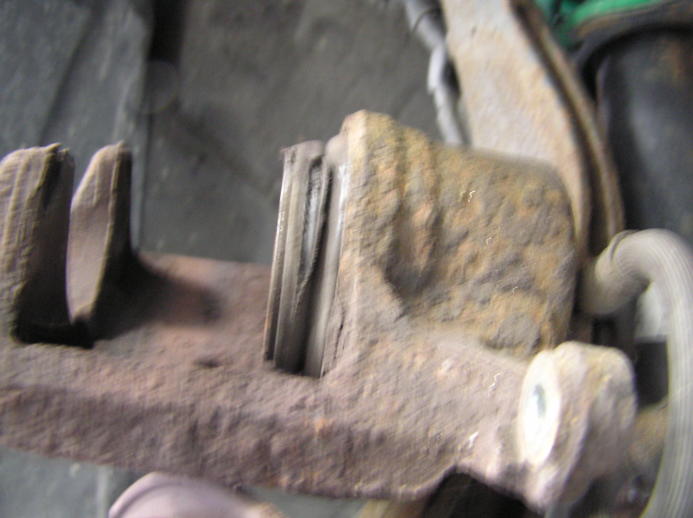

If it's been severely overheated as you say, it's probably cooked its boot and seal and is shot.....so the caliper should be replaced.
But a replacement will also get ruined if there is an underlying hydraulic problem.

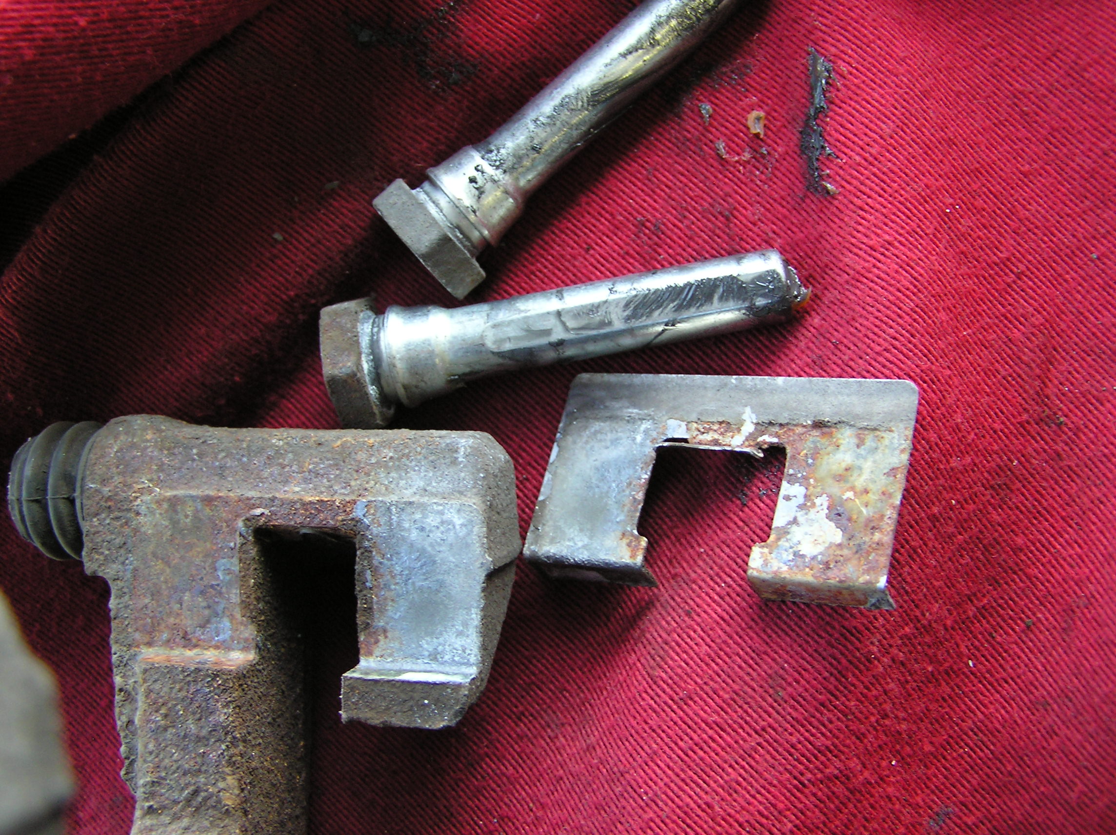

Pads that bind in the bracket.... I remove the bracket and take off the stainless clips and grind out the rust buildup, then coat the freshly exposed bare steel with Silicone grease.
Same for the slide pins.
I'm in the rust belt, I do this on almost every brake job I do.
Other people might just grind down an ear of the brake pad so it fits a little looser.

Cooked caliper, boot split open:

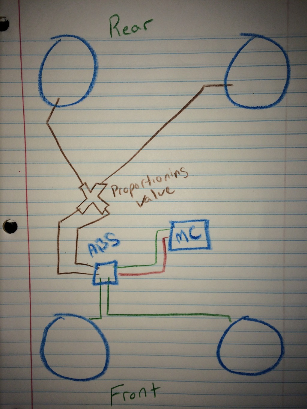

Ok I will be sure to try that. I don't know if you have ever seen an ep3 brake system set up but there are 2 lines going out of the master into the abs module then 4 separate lines coming out of the abs module. One for each caliper. The front lines are a straight shot. The rears go through a proportioning valve. See crappy drawing.
The system is still designed as "dual-diagonal". If you lost one half of the master cylinder, the car would still have one front and the opposite rear brake working.

Yes with ABS connected the pedal returns to rightful position, without it does not.
Problem in the braided line then?
braided line should be no different from a solid steel line, its just a flexible line

Does that sound right though that my problem lies there? Drove better without ABS but still not relieving the pressure from the caliper.

If your going to hijack a old thread, perform all the work already done in said thread..
loosen up each fitting till you find the blockage. 15 minutes of wrench work on you car will save hours of speculations...
This has to be done in a specific order. OP read what I wrote in post #9.
