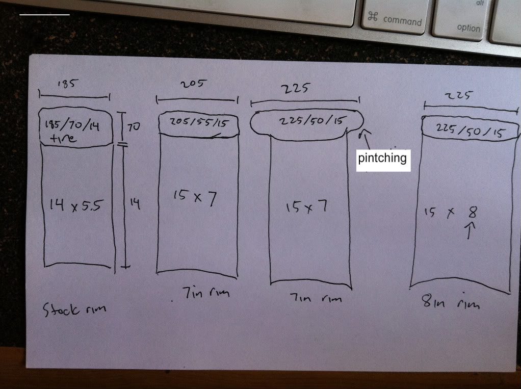

u wont be able to fit a 225 width tire on a 15x7 rim without stretching the tire drastically.
max u can go before stretching the tire is 215. i wouldnt suggest going anymore than that.
i would also suggest you go with 16x7 rims. 16 will give you a 50 profile (205/50/16) which will dramatically decrease your tire-wall flex (and tire wall flex is a big part of handling)
instead of getting wider tires (going 215 or 225), i would suggest getting sticker tires (like nitto 555, falken azeina...etc) and sticking with a 205 width. it will:

hmmm.. can you explain what stretching a tire is? I was under the impression it was sticking a narrow tire on a wide wheel- pulling the sidewall out. Do you mean to say it's the same as "pinching" where you put a very wide tire on a narrow wheel and pinch the tread into a conical shape like a motorcycle tire?
yes sorry, i meant pinching... haha im retarded sometimes...err...most the time.
i cant photoshop if my life depended on it, so here is my sketch of what im talking about:

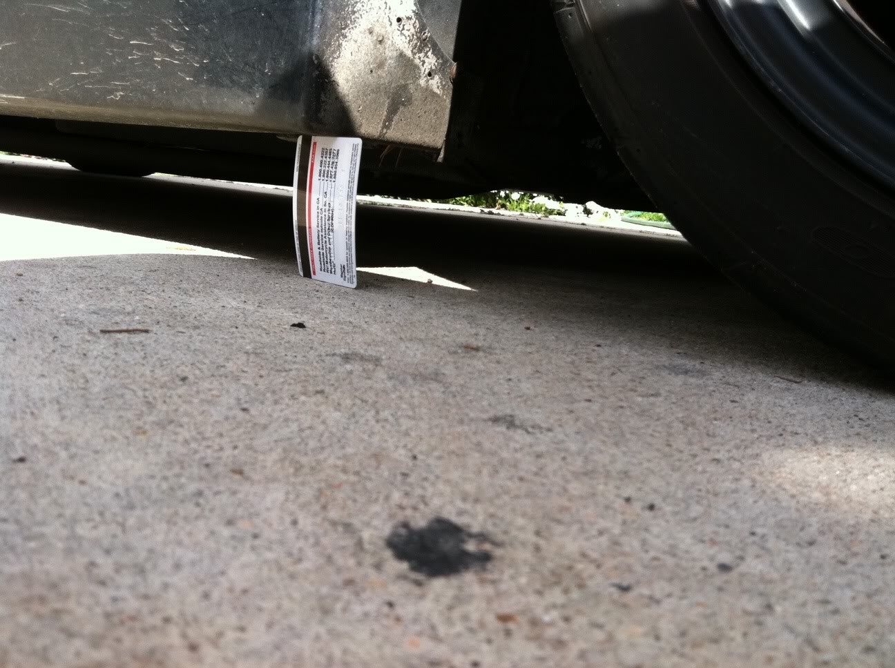

gearbox says i have mudflaps...
i have less than a credicard's length clearance
you just gotta drive slow.... lol but the lower center of gravity is really nice.

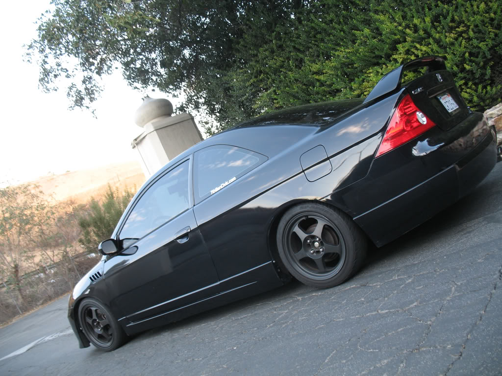

LOL, Actually I wasn't. I haven't been able to find a lot of nice pics.. but this is the pic that sold me (in 18x10 instead of 16x7)
Personally, I'm tired of silver wheels. Thought I'd be going black or gunmetal, until I found hyper-black. I know a lot of you guys don't care for the silver lip but I like it, and haven't seen it much here.
For the record:
Rota SVN 16x7 4x100 et40
Hyperblack/polished lip
rated 15-17lbs depending where you look.
For tires I've decided on a set of Continental Extreme Contact DW (205/50-16)

thats' one of the most extreme body kits i ever seem for the civics - it almost reminds me of an EVO X
Old 04-06-2011
sl33pyriceboi's Avatar
Join Date: Jun 2005
Location: SoCal 714/909/626
Posts: 9,196
Received 1 Like on 1 Post
Rep Power: 328
Re: Wheels, GC & Koni yellows... a little help plz
loll
Told you I couldn't find a lot of nice pics! LOL
Still that's the pic that made me like 'em. Just received the confirmation email they should be here Friday. I'll get pics up to show what they look like on a silver civic soon.
