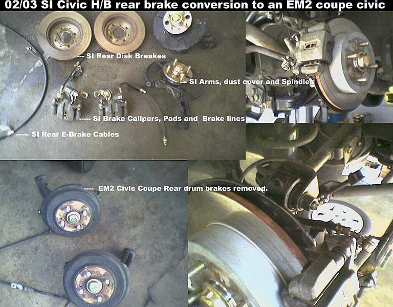

from a post of punkingcivic (who i think got the pics form someone else?) from back in the day. get a visualization of the parts...
