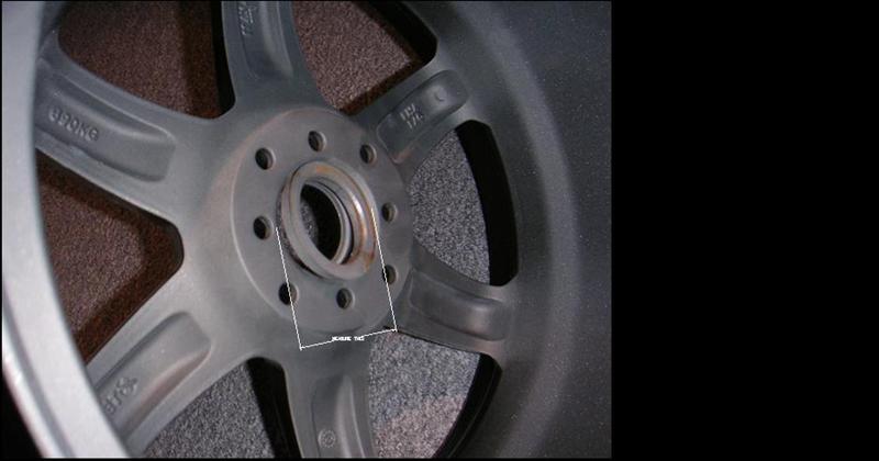

What exactly am I looking to measure to figure this out, bought RH CP-8 this winter, never been on before.
Thanks
Name:	Cbore (Medium).JPG
