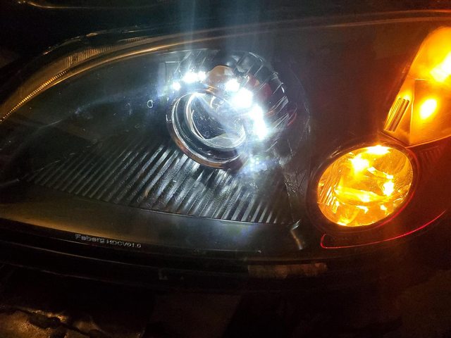

Re: newbie modder looking for tips!
Originally Posted by sp3ktrumz
oh yes becuase the entire housing lens is designed to disperse light from the OEM halogen bulbs. well I will call and ask them for entirely new housing and then get an LED projector suitable for that specific housing hopefully
I went on TRS and searched for 01 Civic ES1 but they only gave me bulbs, no housing or projector kits recommended so not sure what is implied here...meaning I just plug-n-play the LED light bulbs on OEM housing but thats problematic?
because the stock headlight is no good for any offerings of led bulb replacement
but most get a new aftermarket headlight with projectors somewhere, remove the projector and installs the morimoto mini.
this is the set i bought from xriceboyx, clear lenses and morimoto retrofit
do they have them in black and chrome so the signal and parking isnt amber/orange plated frame? so are those housing the default original socket for the bulbs to be inserted and you dont need to modify them to make the diameter/circumference of the opening to be bigger to allow the morimoto mini?
ill just go that route to be safe and HID systems are so difficult to wire together.
could I potentially use these housings:
1. https://www.ebay.ca/itm/304442814378...3ABFBM3PqG1aVg
or 2. https://www.carid.com/2001-honda-civ...parentsubmodel[]=SUBMODEL|Sedan
or 3. https://www.carid.com/2001-honda-civ...parentsubmodel[]=SUBMODEL|Sedan
xriceboyx is a member here, i bought the setup from him, he is not a headlight maker/seller.
also, the bulbs are amber (safety), not the lenses
concerning the 3 options you listed, ask TRS, they might know
if you go the HID route, need to understand the system, you are going to need ballasts for the HID
