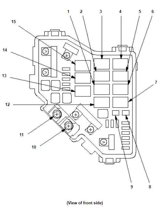

I don't have schematics for the hybrid so hopefully the ones I have are accurate. Check fuse 36 (10A) in the under-dash fuse box. Check fuse 6 (20A), 7 (20A), and 20 (7.5A) all in the under-hood fuse box.

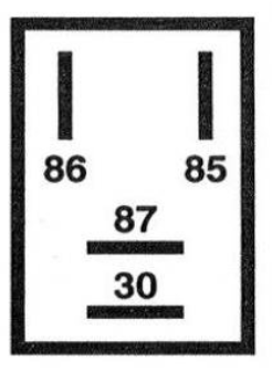

Jumping the compressor relay to see if the compressor turns on will help narrow it down. However, it shouldn't make the fans turn on so don't leave it. Compressor relay should be reference number 12 in the under-dash box. What you want to do is remove it, then add a jumper between pins 87 and 30 on the fuse box side. Engine should be running already, look to see if the compressor is now engaged.
