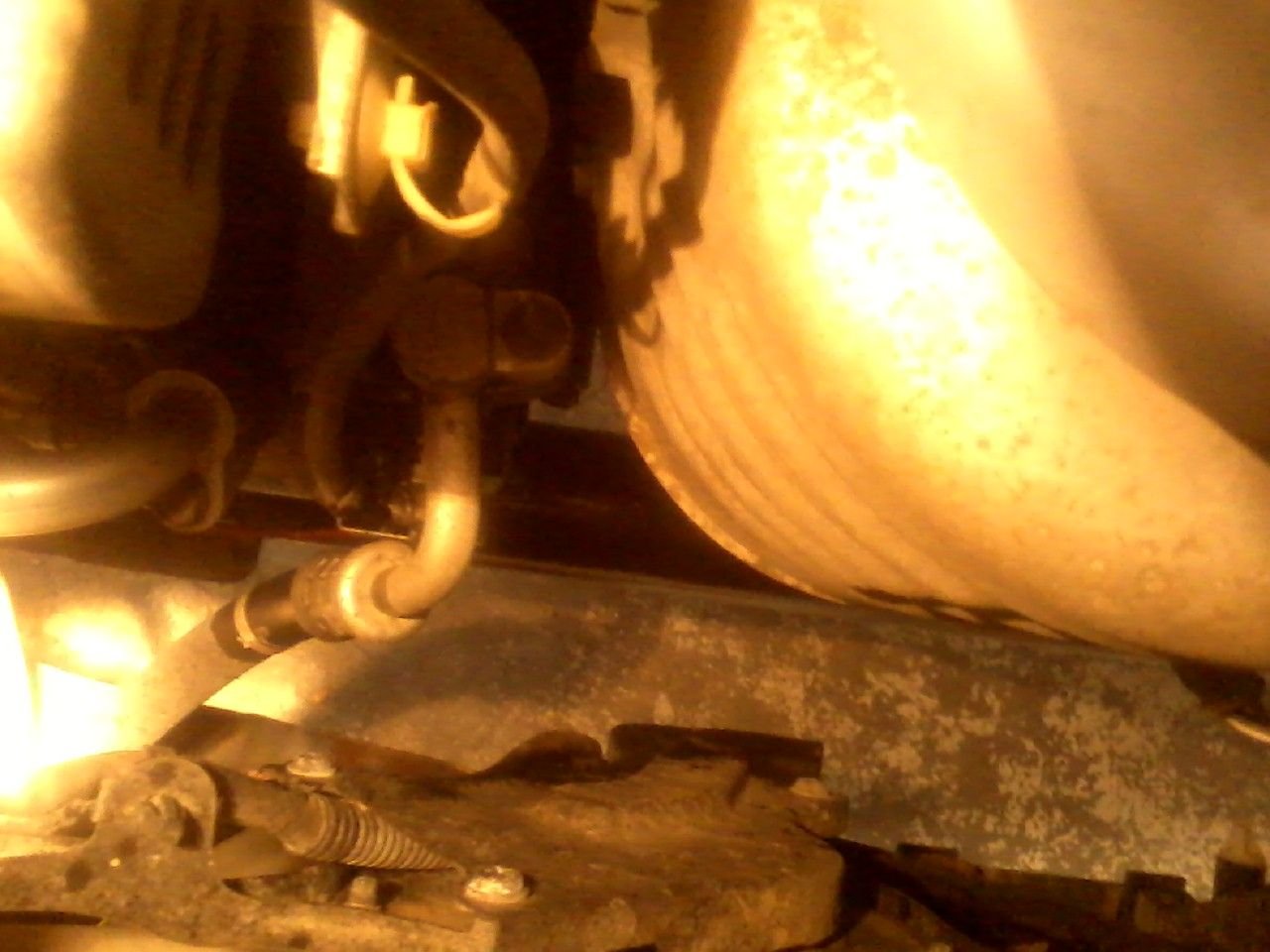

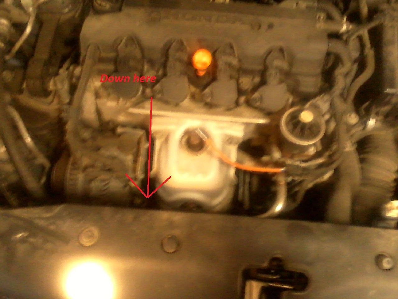

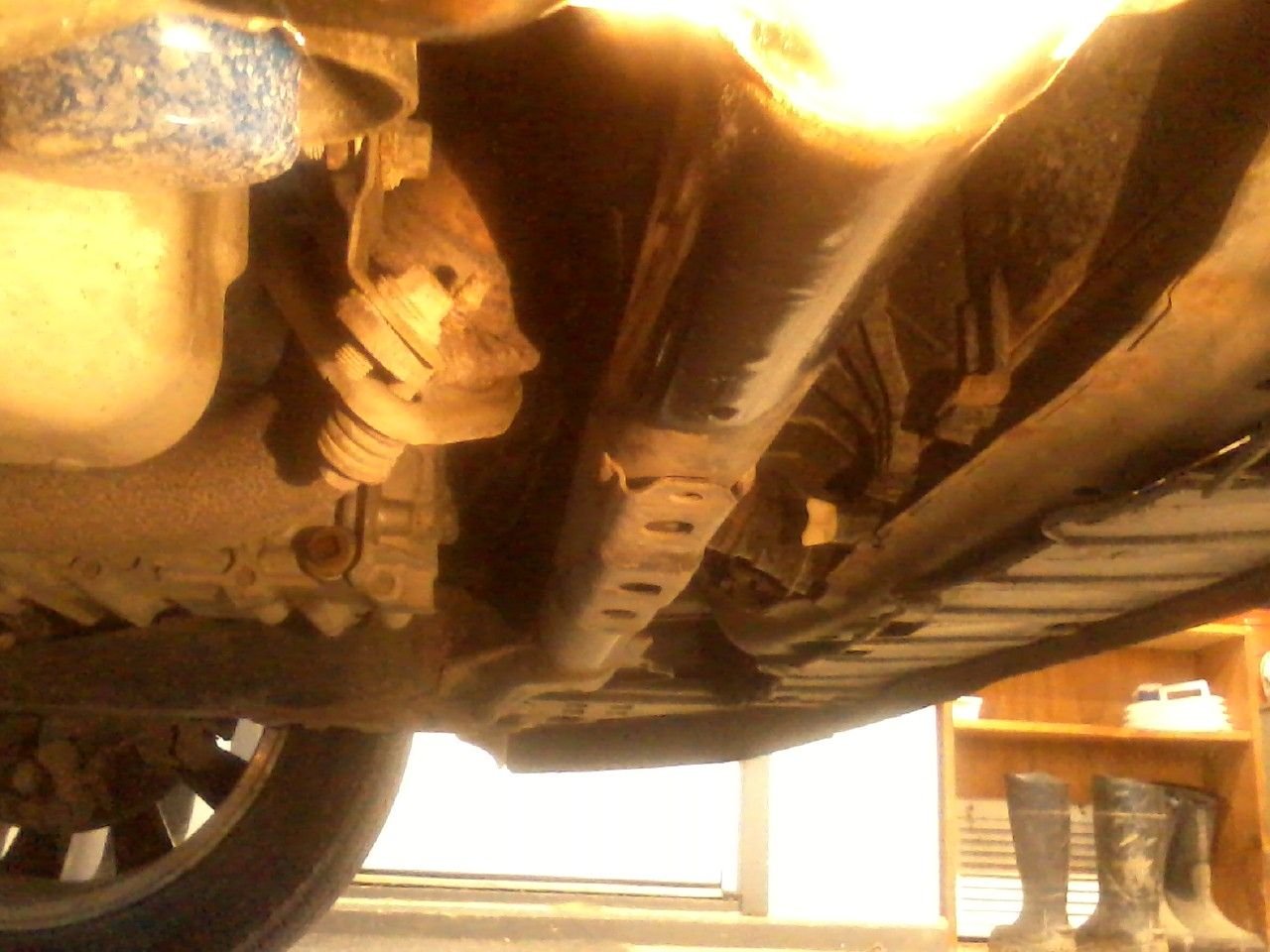

Okay, since I can't get the car into the dealership until tomorrow regardless, I took a close look to see what I can find. And I've found evidence of some sort of fluid leak. Part of a chassis crossmember is absolutely soaked with something oily(can't tell what). I have included photos, though they may be tough to clearly identify due to my crappy cell phone camera. One's an overhead shot of the soaked piece, one's a shot from underneath, and one's a shot of the engine bay in which I've added an arrow pointing to the general area to help illustrate where it all is.
There is no puddle or spot of fluid on the floor underneath this point. There IS a spot of moisture on the ground further back, up in the vicinity of the firewall, but it appears to just be water - it did not feel oily when I touched it.
Hope this helps.

Got word from the dealership: A/C relay switch was broken. A/C compressor was on at all times. Fluid was lubricant from inside the A/C pump. Grinding/screeching, despite not sounding like any belt slip I'd ever heard, was fluid getting on the serpentine belt.
Got it in before any serious damage occurred, but A/C may need recharging afterwards. Not gonna have the dealership do it because, as I just noted, I don't need it this time of year. (and also, I have a recharge kit here at home to do it myself)
