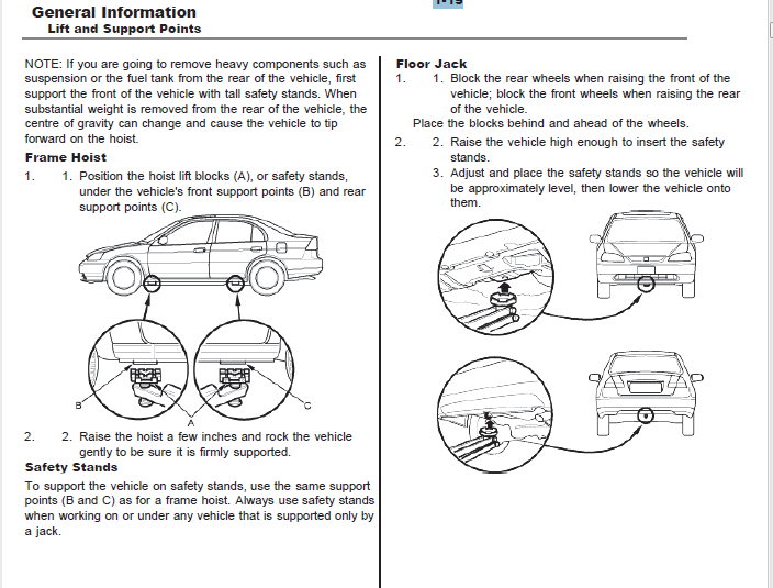

I suggest downloading the repair manual https://www.civicforums.com/forums/182-7th-generation-civic/235295-looking-7th-gen-manual-free-updated-13.html
The last post on this thread has a link for the EM2 manual, it comes in handy.
Heres a pic of the lifting points on the car. U can use a jack to jack the car up from the front and use two jack stands on the sides, this way you can go under the car safely. NEVER go under a car using just a hydraulic jack and no jack stands, unless you want to be a pancake
Check for leaks on the rack now that u can.
The fluid should be no more than the max, so after flushing and filing, get rid of all the air and re-check to fill it up again if needed. Just how the procedure ezone linked to says.
Thank you, thank you. I didn't have that repair manual. Awesomeness. So I can use the jack that comes with the spare to jack up the front? I was afraid it would only be suitable for the side when changing a tire. And thanks for the safety tip. I'll pick up a couple of quality jack stands. Doing metalwork and woodwork, I work with a lot of stuff that can blow me up or mangle me, not crush me. This will be new!

Originally Posted by ezone
Ive used chunks of wood, bricks, etc.
My dad made ramps out of 4x4 lumber...wheel chocks too.
I thought about the DIY option, but this is for my safety and I prefer to spend the money on proper safety equipment (especially if it's not that expensive).
