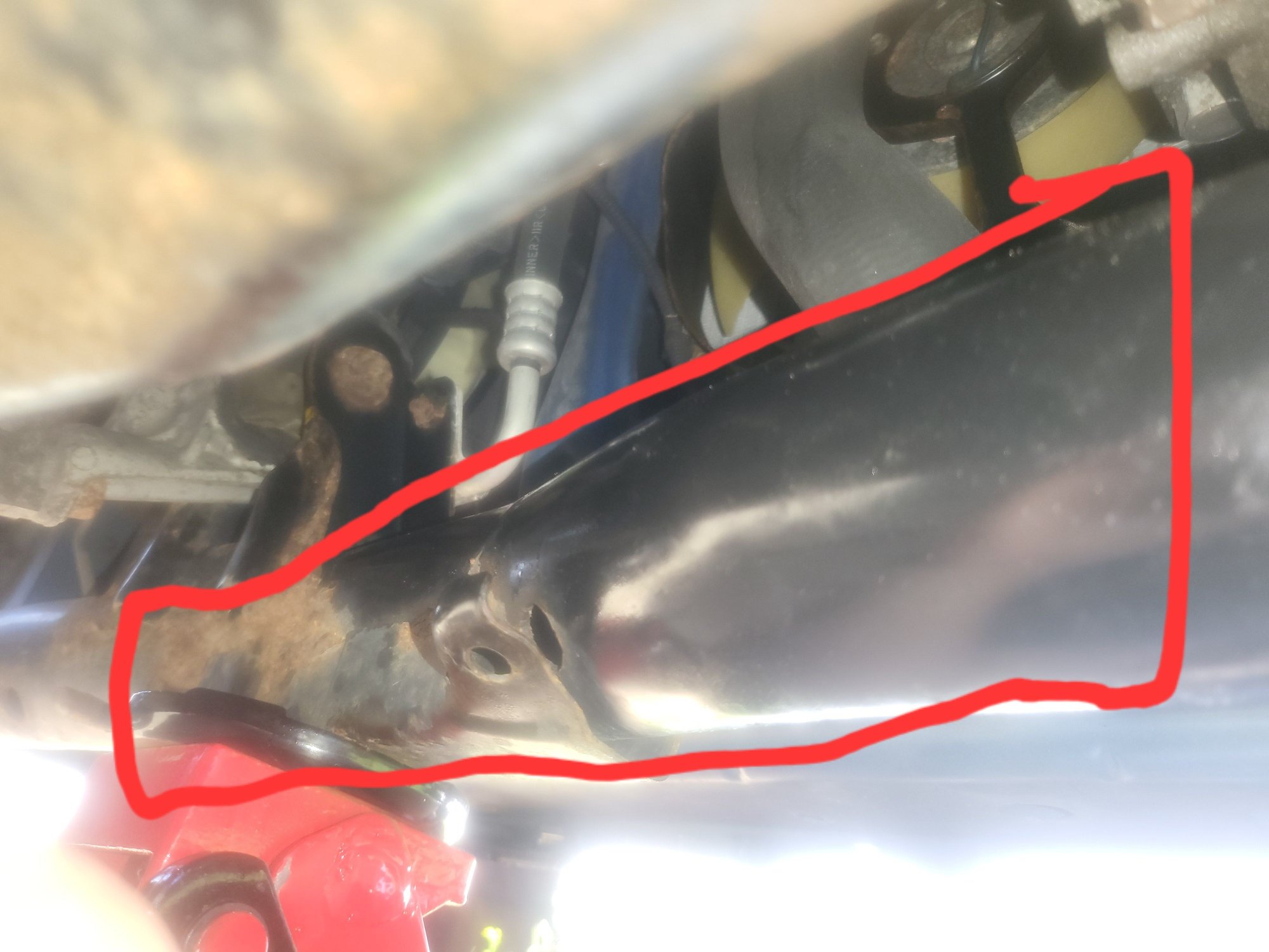

Hey! I'm trying to replace the ac compressor on my ep3 without dropping the subframe. I've heard it can be done similar to how the alternator is done. That is, up through the passenger headlight by moving back the radiator. However, upon taking everything off, the very last bolt to complete this removal seems to be impossible to remove as it is blocked by the subframe. Again I'm novice so I'm trying to avoid dropping the subframe even a little. Any ideas? I'll attach a image of the bolt and of the bar circled in red if I can figure out how.
Thanks!
The ac compressor bolt pointed to in red
The bar blocking it(subframe?) Highlighted in red.

Undo an engine mount, raise or lower the engine, and then get the bolt? That's what I would try

This may be a dumb question but you said "an engine mount". Could I undo a singular corner? I'd probably only need an inch or two. But I'd need a cherry picker for that would I not?

Whichever mount is closest, probably where the belt and pulleys are. 2x4 and a floor jack under the oil pan.

Won't damae the engine? I've always assumed the oil pan wouldn't be able to hold the weight of the engine. I suppose it's got the 3 other mounts though in this situation? Thanks by the way!

hondas have sturdy pans.
changing clutch involves jack under engine holding it up
other manufacturers have pans that can get a dent, hondas seem ok

The 2x4 spreads the weight it will be fine

So before I try the "lift the engine" idea, I found a YouTube video of someone doing this by completely removing the radiator which gave him access to the bolts from the front looking back. Is there a chance someone here can confirm it's possible this way? I'm unable to try either way until Friday due to some upcoming events this week.

Then you have to drain the coolant.....
engine mount is a lot simpler.

You don't need to fully remove the bolt. Use a wrench or socket to loosen then remove the compressor with the bolt still in the hole.
However, I don't see how it's possible to remove the compressor without dropping the subframe.

Was able to do it by removing the radiator completely and then was able to access the bolts from the front looking back. I was nervous to drop the subframe or mess with motor mounts because I live in the rust belt and bolts snapping and/or rusting out is extremely common

You're more likely to break a radiator support bracket bolt than any engine mount or subframe bolt. But I understand what you're saying. I'm in Ohio and deal with rusty and crusty bolts all the time.
