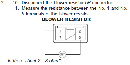

re: Blower motor '03 Civic quick question [solved]
I would sooner suspect the blower resistor.
Hooking directly to the battery does not give it more "power". Here is a snip of the blower resistor troubleshooting from the service manual if you're interested.
The factory manual says if there is battery voltage at the 2P connector, replace the blower motor. The other steps come before testing the 2P connector. There is full BV at the connector.
My resistor is 4 pin and isn't shaped like your picture. I did some tests on the resistor plug and it was good. However, I didn't do all the tests
Yes I saw that as well. But the fan working when connecting directly to the battery indicates an issue with the fan wiring, not the fan. There is a diagnostic mode you could run to see if the HVAC has any faults.

Thanks Brotato. I checked the resistor and the ohms test passed at 1.4 and then the second test showed a bad resistor. So, now the system is working thanks to your help.
I still don't understand how 12.6 V at the fan plug, supplied by the resistor would not start the motor. Yet 12.6 V from a battery would.

Re: Blower motor '03 Civic quick question [solved]
What second test exactly? 1.4 ohms is technically outside of the range given in the troubleshooting step.
The resistor actually controls the ground side. Bad resistor would mean no ground. You would still have battery voltage on the other pin though.
