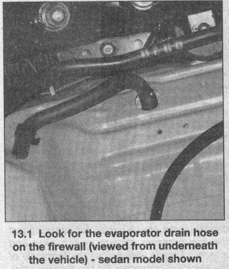

If youre asking where the drain hose is, heres a pic. you cant miss it
