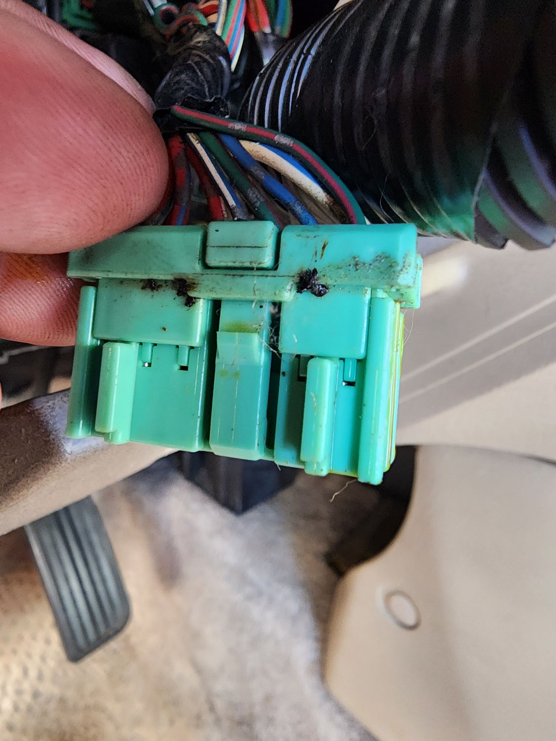

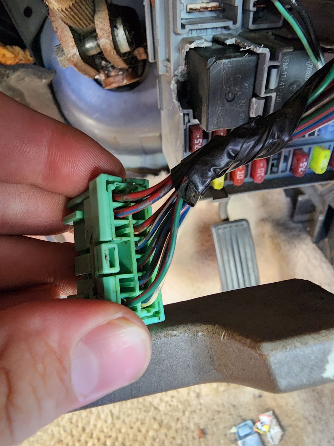

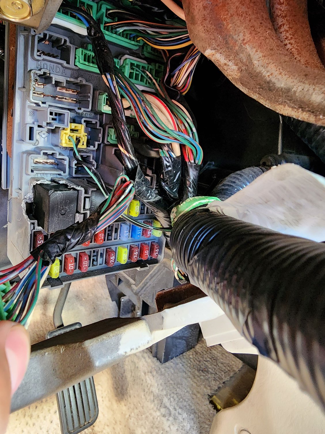

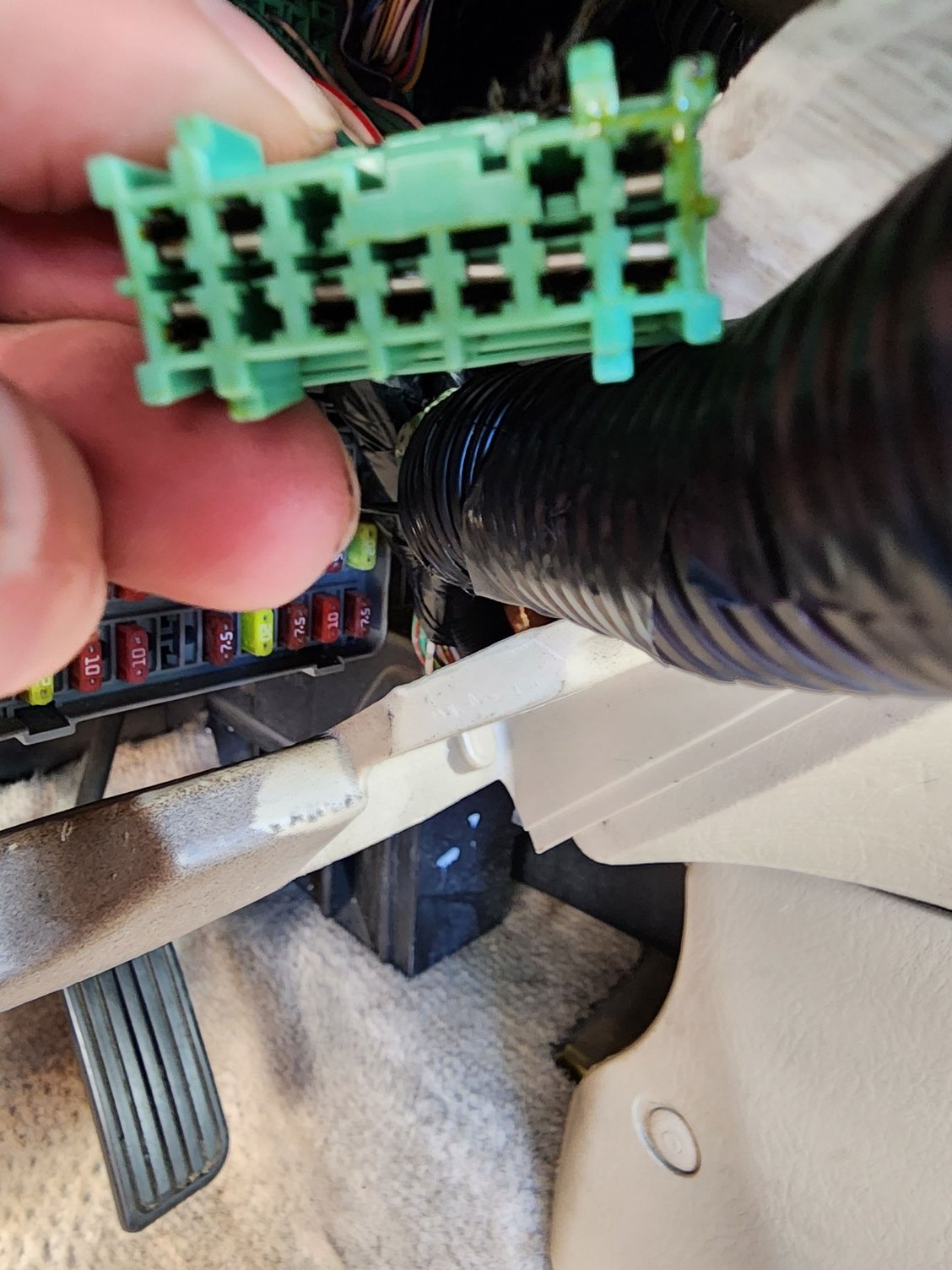

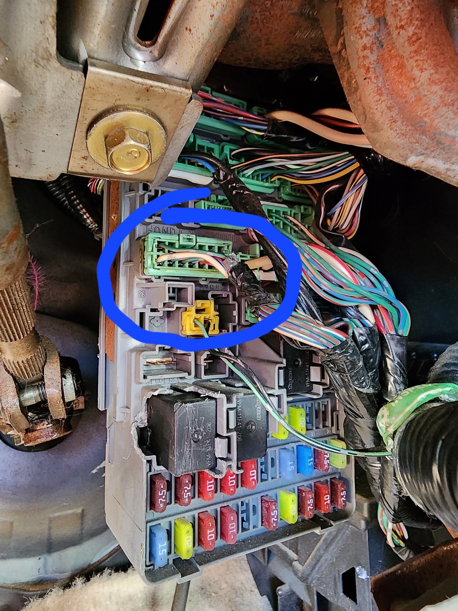

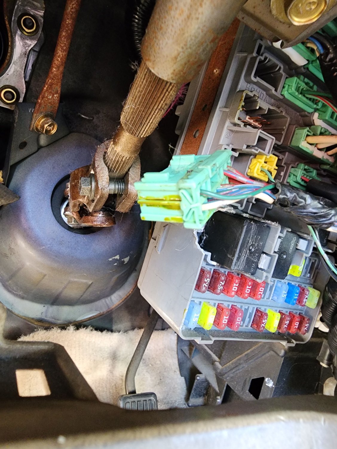

Quick update. I checked on the steering column for any sign of burnt wires, and the connectors and couldn't find anything. I did however happen to find this connector that is plugged into the fuse box inside the car, drivers side that looks like it's partially burnt with this weird grease on it. I don't know how to test if this is the short, or what it's exactly called, or what to order to fix?

Doesn't look like its' burned to me.
