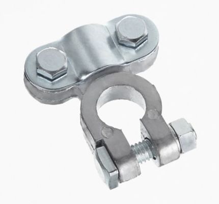

Re: 02 Civic LX no crank no start
Does it look like this?
The cable ends can get corroded under the clamp and cause a no crank problem
Thems the ones. I'm on my way to pick up some replacement cables and terminals. Hopefully this works.
They're garbage, you might be able to cut the cable back a bit to get to clean metal
