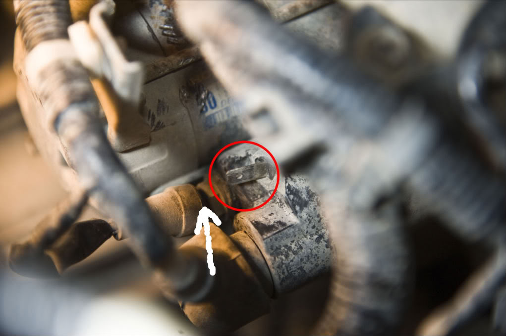

Well i went in there with a good light and upon inspection of what i think is the starter right next to it looks like some kind of solinoid and there is a wire hooked to it which to me looks melted.
So i unhooked the wire and turned the key over, all the lights work again got the windows rolled up.
So this leads me to believe that the starter is seized up and when go to start it,it shorts everything out?
or that solinoid just shorted out? or both?
what do you guys think i took some pics just so you can tell me what you think?

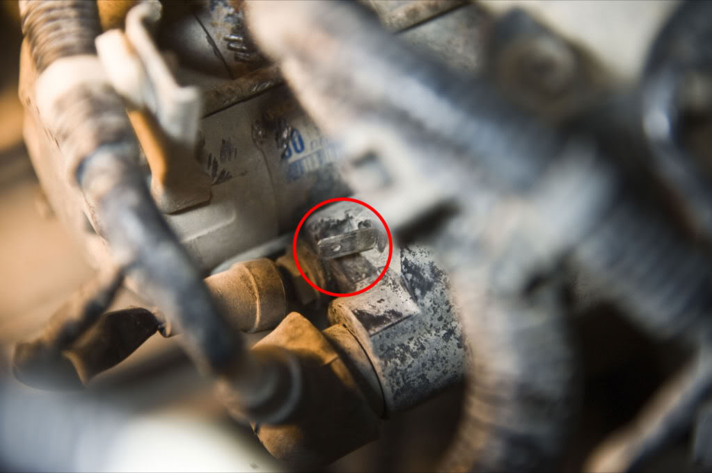

Yeah, that's the starter solenoid, it pushes the starter gear forward to connect with the flywheel. And by the pic it looks like you have a manual tranny.
1. Check for continuity between that terminal and ground.
Is there continuity?
YES- step 2
NO- replace the solenoid
2. Check for continuity between that terminal and this one:
YES- solenoid is good replace the wire. It runs from the starter to the starter cut relay in the under-dash fuse box. The starter cut relay is the bottom left relay in the under-dash fuse box. Make sure to use the same gauge wire or it will burn out again.
Post back if you need to test the starter.
