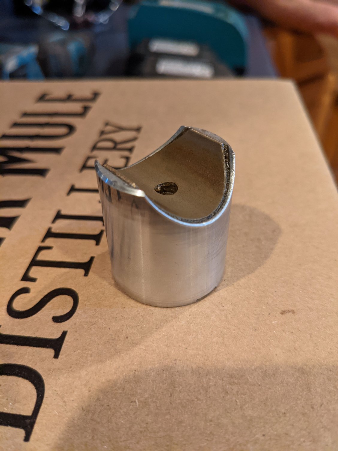

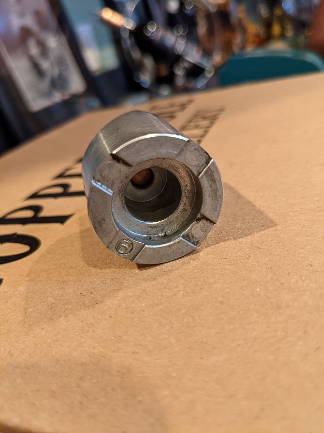

Found this thing resting where the lower control arm mounts to the frame on the drivers side. No clue at all what it is. It simply has to be something kicked up by the tire and left there for me to wonder about, but enlighten me, if you know what it is. Some kind of piston or vvt part?
Unknown item
Unknown item #2
Doesn't look familiar to me.
