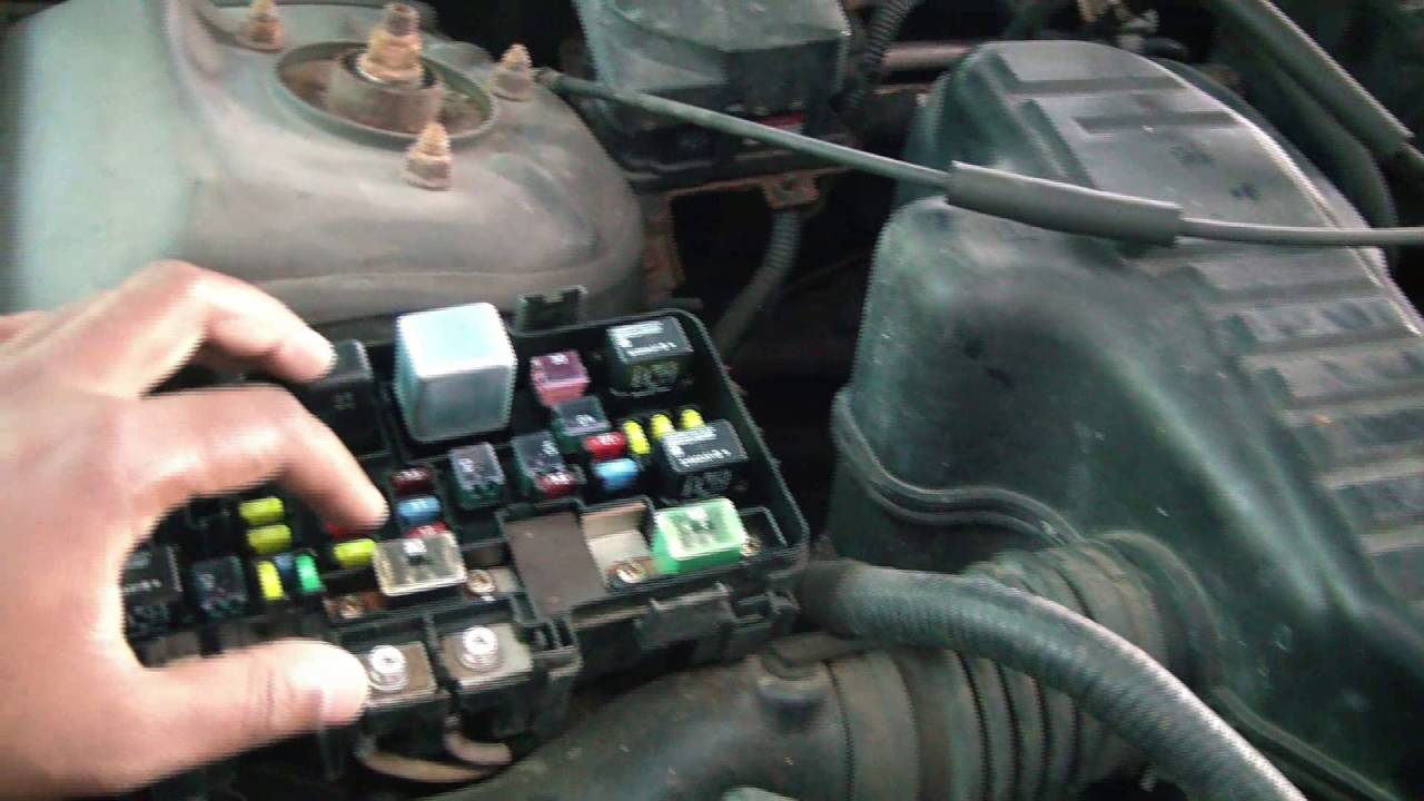

I found an IGNITION 1 fuse in the engine compartment fuse box. It's #20, the lower right light green fuse.
Would this be the problem?

Not sure what your trying to say about that fuse, does it keep popping?

I was thinking that the Ignition 1 fuse had something to do with the problem.
