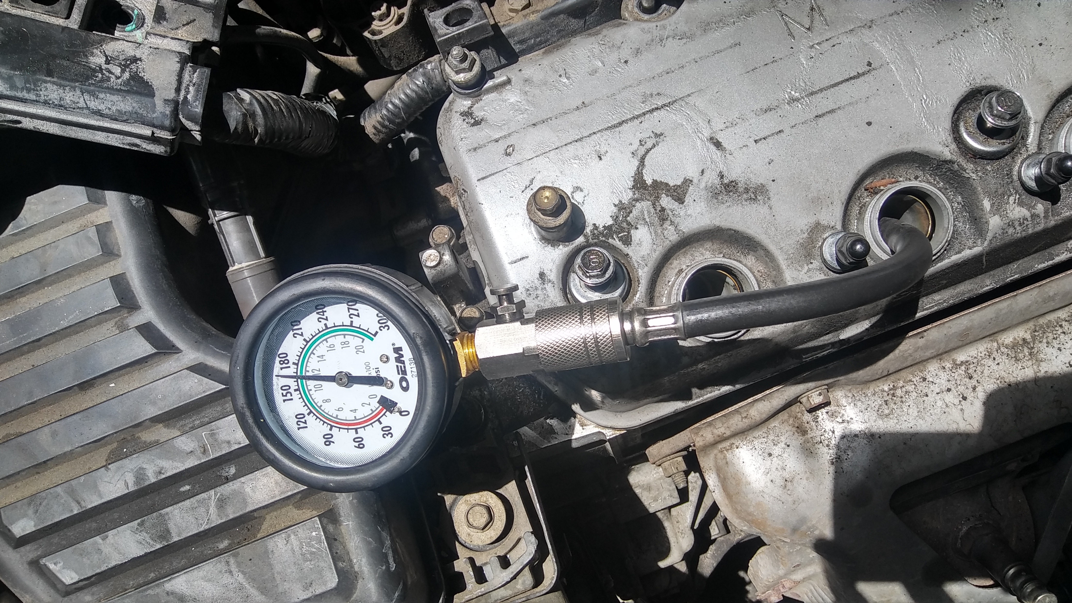

The above information saved me a lot of hassle. I had similar problem as in the thread opener. The engine would start momentarily and shut off so I checked the sparks on 4 cylinders by grounding each one and cranking engine. Since vehicle started momentarily, i was safe to assume that fuel was getting in cylinders.
When i checked the timing it was off by 4 to 5 teeth, about 10 to 15 degrees off on balancer shaft, Keep in mind this was for HONDA CIVIC 2002, dx, 161K miles, D17A1 type engine, which is interference engine.
Autozone lets you rent Compression Tester ~$45.00.
I reset the timing on the engine and did a DRY COMPRESSION Test, 2.5 seconds of cranking per test per cylinder, Each compression was above 160 PSI.
Then I did a WET COMPRESSION Test (put little oil in cylinder), similar test setup as described above. The compression was 175 PSI minimum. This told me that the rings maybe worn slightly worn over the life of engine.
$41 bucks for Timing Kit from E bay.
Total time for opening and troubleshooting was 5 hours not taking hunting for proper tools for the Job.
Hope this helps someone in the future.

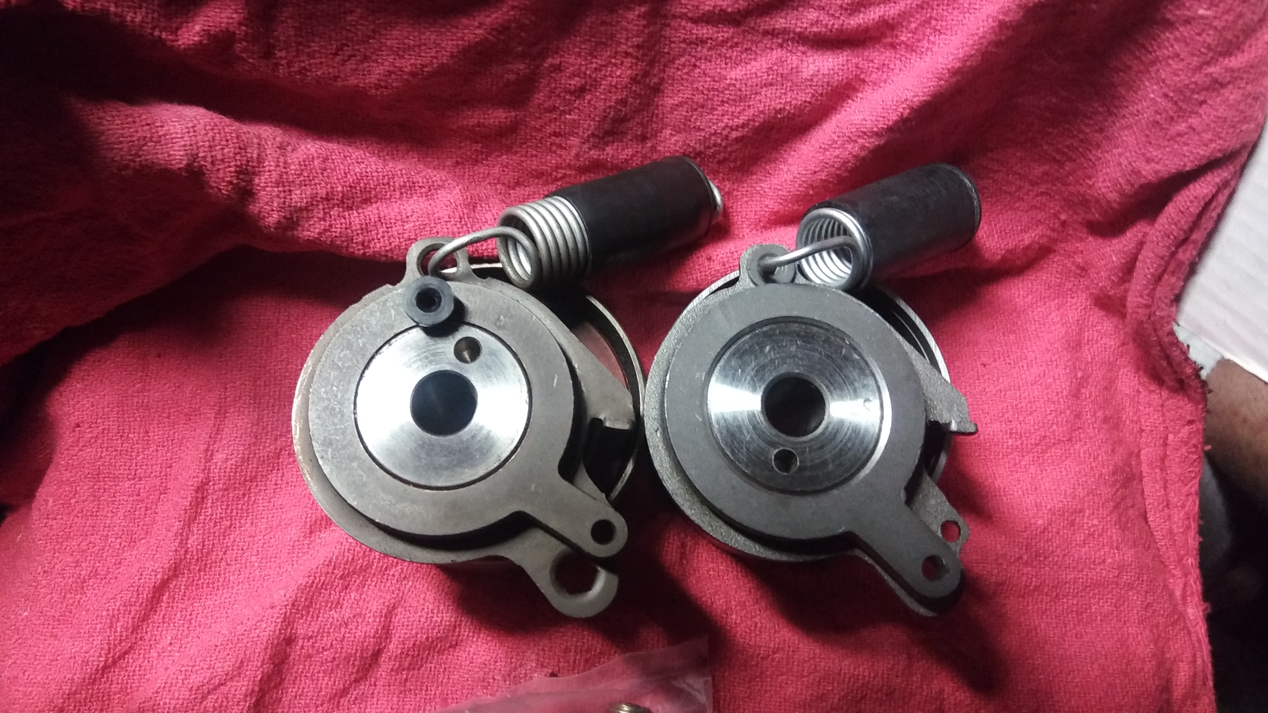

POSSIBLE CAUSE FOR SLIP:
1) when I opened the timing belt covers, the belt felt taught. The tensioner spring seems on the weak side and i felt that the tensioner was not moving very easily. It could be the that tensioner bearing could be getting worn and the mechanicals mechanisms were on its was out. The Spring Constant of a spring changes over time especially when engine temperature changes, the spring loses its "springiness".
2) The belt may have been stretched over time and usage. Normal Wear and Tear.

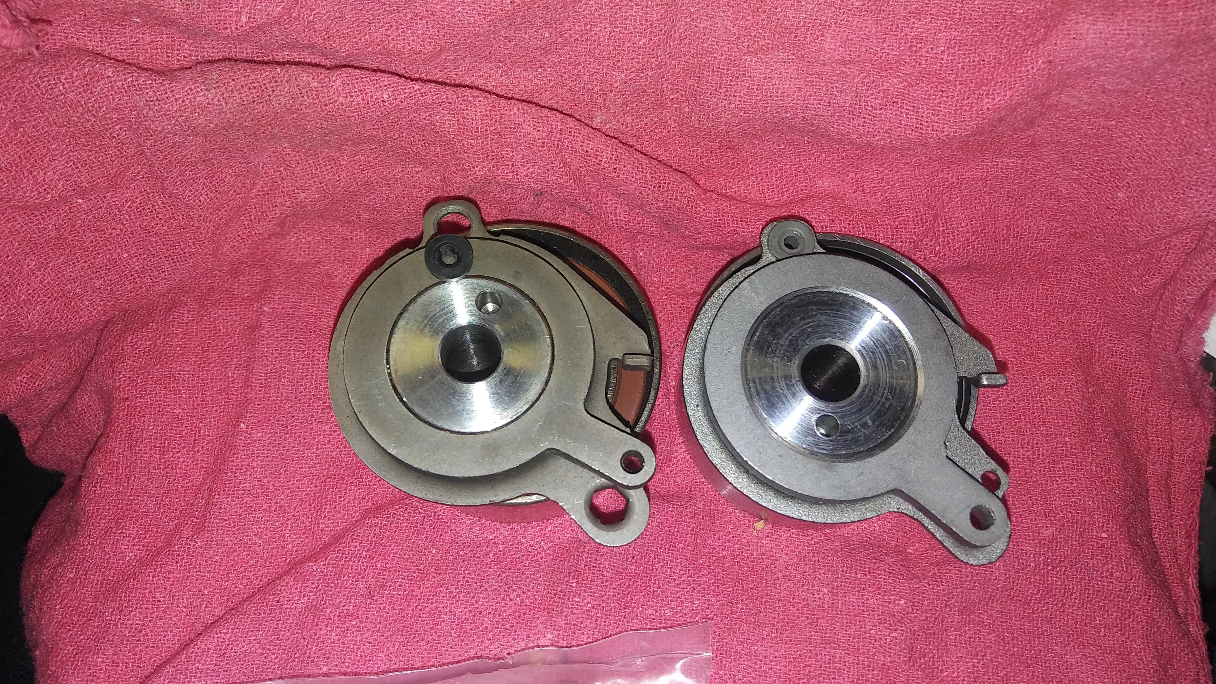

Had Same problem as the thread opener.
Opened timing cover and found timing off by 4 teeth, there are 104 teeth on cam sprocket and 4/104 is about 13 degrees on crank shaft. I reset the timing and performed compression tests and they all came out (DRY Tests) to be above 165 PSI. The test duration was 2.5 seconds per cylinder.
Ordered the parts KIT for $41 from e bay and when I opened up tensioner/damper for timing I found eyelet dangling in tensioner spring. Since spring was lose on tensioner, the DAMPING function of the tensioner was was not there during fast torque changes demanded during acceleration. The belt skipped some tooth and the timing was off. After kit was installed and timing was put back the car ran strong as ever!!
