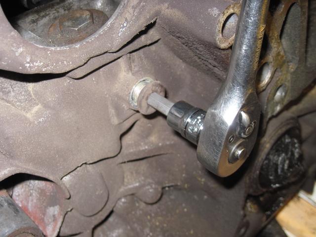

Old Jan 22, 2013
marshallinux's Avatar
Joined: Jan 2013
Posts: 22
marshallinux is an unknown quantity at this point
Re: Won't shift into any gear after reinstallation of manual transmission
Originally Posted by ezone
I can't picture that in my head.
Can you post a pic of this so we know what you mean?
I hope you can see the pic. It's the bolt on the engine side of the transmission.
Old Jan 22, 2013
Rep Power: 518
Pic fail.
EDIT: Blow that pic up
Trying to think of where that is.......
Back out so I can see more around it?

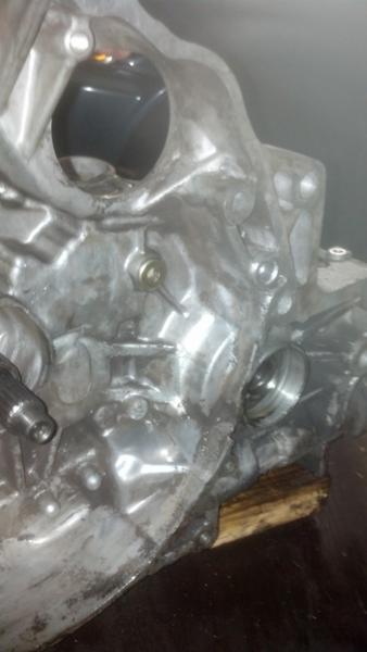

Old Jan 22, 2013
Joined: Jan 2013
Posts: 22
I didn't take a good one... Is that a good enough pic?Click image for larger version
ID:	84587Click image for larger version
Name:	2013-01-22_21-02-41_890 (copy).jpg
Edit: how about these?Click image for larger version
Old Jan 22, 2013
Rep Power: 518
Ok found it.
How near to the end of the threads is it when it works, and how close is it when it jams?
Is there a sealing washer missing from that? That might would let it go too deep and jam the mechanism if one is missing. I can't tell.
Parts doesn't show a separate seal/washer/spacer.
Otherwise, if all on the outside of the trans is proper then something is still wrong inside.
Your shift interlock mechanism (squared cup thing with a slot?) isn't lined up in the right spot for that bolt to go all the way in.
Is the trans still on the bench? Bright flashlight, look down in that hole and see what is wrong.
(I'm trying to see this from a pic of an exploded view. It's been a while since I had one of these apart.)

Old Jan 22, 2013
Rep Power: 518
Pull the bolt back out.
Look deep in that hole, see what is in the way. I think the mechanism needs to move to line up the slot for the bolt to go all the way in (assuming it's assembled properly inside there).
Old Jan 22, 2013
Rep Power: 518
EDIT:
I'm assuming the tip of the bolt has to fit through a slot in the side of that square-ish interlock thing....and it just isn't lined up to the right spot yet.
Old Jan 23, 2013
Joined: Jan 2013
Posts: 22
I looked at that hole for a while and played around with the shift and now understand what you mean about the slot. I don't see how it could be misaligned though. I didn't touch the shift rod inside the transmission at all.
That said, I noticed that when I put a washer on that bolt and tighten it, it works. But I don't recall that there was a washer on that bolt...
Old Jan 23, 2013
Rep Power: 518
You removed the bolt, things moved inside the trans. You moved other stuff that moved the interlock.
You just need to put it back.
It might only need to move 1mm or something, but it needs to move one direction or another to align the slot. Pocket screwdriver?
I HOPE you didn't bend or otherwise damage something by jamming the bolt in there.
Since I didn't find a washer in the parts catalog, I assume there isn't supposed to be one. Does it have an O ring seal or something?
No matter, if it didn't have a washer then don't put one in there. It ain't right and you will only trash something.
If you stick a washer on it, the interlock won't work right.

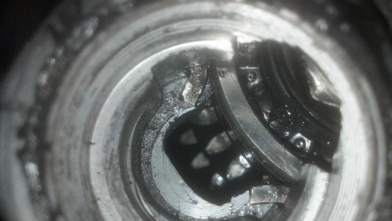

Old Feb 1, 2013
Joined: Jan 2013
Posts: 22
So I received those new interlock & bolt, and I've put everything together inside the transmission. I have verified that I can shift to all gears with the interlock bolt in.
However, I can't get the snap ring to get in the groove on the bearing on the countershaft. I pushed the transmission housing on the clutch housing with the snap ring open (w/ a snap ring tool), but the snap ring sits just above the groove. The two housing are already flush with each other. Please see the pic.
Is this a major problem? If so, what I can do to fix this??? Thanks!
Old Feb 1, 2013
Rep Power: 518
Ummmmm
How close or far is it from getting the snap ring into its groove?
Use some sort of hook to lift the bearing up.....
or turn the trans over and sort of jiggle or bang the whole thing on the bench so the weight of the shaft moves the bearing.
OTOH, this might indicate there is too much clearance somewhere since that shaft should have shoved its bearing all the way into that hole. Recheck?
Bearing installed the correct direction?
Old Feb 1, 2013
Joined: Jan 2013
Posts: 22
The bearing is definitely in the right direction and the snap ring is maybe 1 mm away from the groove. The bottom of the snap ring is almost above the groove. So close!
I think I'll try the gravity thing you suggested real quick
Old Feb 1, 2013
Joined: Jan 2013
Posts: 22
no luck with the gravity & banging on the transmission etc...
any suggestion for a hook-like tool I can use to lift up the bearing?
there is a couple mm of clearance b/w the bearing & the case, but it was like that when I took it apart. I think it's by design for the countershaft's position to be secured by the snap ring.
Old Feb 1, 2013
Rep Power: 518
No tool suggestions other than improvise.
Channellocks?
Ladyfoot prybar?
I was thinking more of a method than any specific tool.
Don't FORCE it.
If it won't go, then you may need to take it apart again to figure out why.
Old Feb 1, 2013
Joined: Jan 2013
Posts: 22
After some more gravity attacks and improvising a tool from a long bolt, a nut, a wrench, and a long socket and pulling the bearing groove through leverage, the gap between the snap ring and the groove is definitely less than 1 mm. Slightly more than half of the snap ring is hovering above the groove.
I think that if I dropped the transmission upside down from the second floor, the bearing would go "up" enough and let the snap ring snap in, but somehow I think that's a bad idea...
Then I tried tightening all the housing bolts (10 ft-lbs first then 20). Now the gap seems to be even less than 1/2 mm, but it just won't snap in there yet. At this point I'm thinking about just installing the transmission and the snap ring will find its way into the groove as I'm driving... what do you think?
The countershaft cannot shift any closer towards the engine b/c there is a bearing and an oil guide that it sits on. If the shaft were to shift away from the engine, it would definitely be caught by the snap ring (there is ~1-2 mm clearance on the other end between the case and the end of the shaft).
Old Feb 1, 2013
Rep Power: 518
You know from two stories up
A Zenith makes a big boom
He!! no.
It's not supposed to be that difficult to get the snap ring engaged. Something isn't right.
