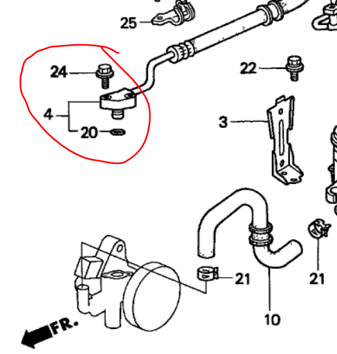

These bolts? Part number 95801-06030-08. It's an M6 bolt, 30 mm long. Unsure on thread pitch, maybe 0.75.

Yea that's definitely the bolts I'm looking for. Thanks for the part number, I was able to find them on HPN and get em. Also where did you get that diagram from?
online honda parts dealers have diagrams.

Found it on HPN under Chassis, P.S. Pipe.
