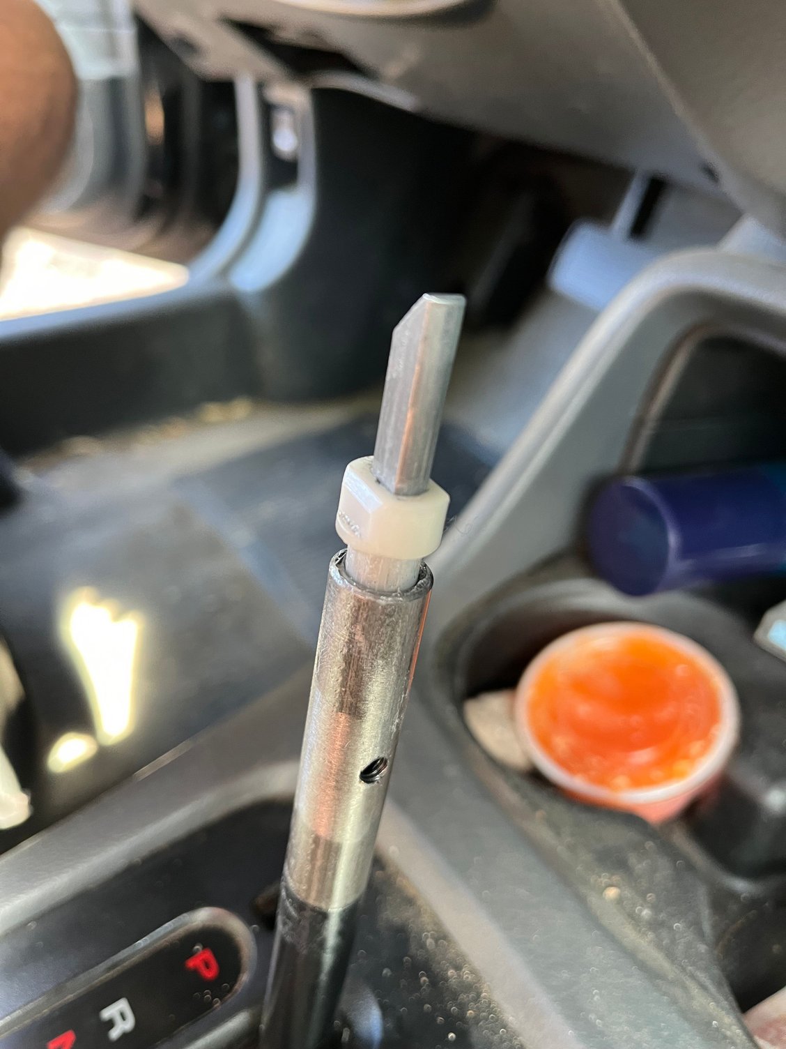

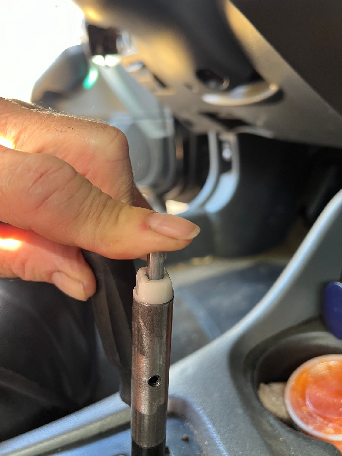

I’m having the same problem. Shifter **** screws came out and won’t line up to shaft. I tried pushing down the interlock switch. It does let the shaft go further down . But it won’t stay down. I tried holding the switch down while installing the mounting screws but I still but I still can’t get the key out. No shifting issues before the ****/ handle flew off one day . 1st photo how the shaft looked after the **** came off, 2nd photo travel of shaft with the switch deppressed.
