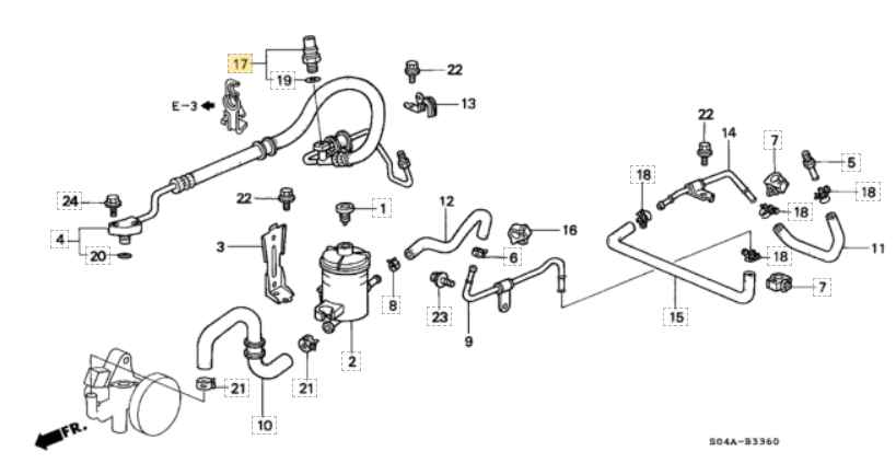

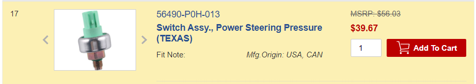

I found it. Power steering pressure switch. This sensor would tell the ECU when the power steering is under high load so the idle could be bumped up a little.
Thank you very much! That might explain why the car vibrates a little when I turn. I thought that was normal behavior for an old car

Now to figure out why that sensor isn't in the hose. Does the hose have a plug in the port for that sensor?

You can buy the line with or without provisions for the sensor, it was probably a couple dollars cheaper, and whoever did the repair didnt bother looking.
