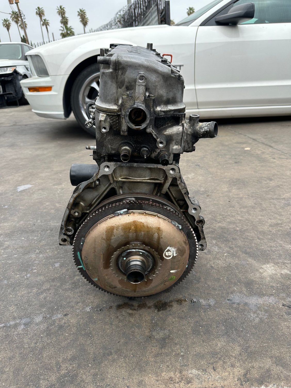

also the replacement engine showed up and the seller lied about the mileage and condition so I sent it back. Showed up with triple the mileage it claimed to have and Low compression on cylinder 1 and 2.
Decided on a complete rebuild instead. Found a local machine shop/engine repair that was willing to do the work for a fair price.

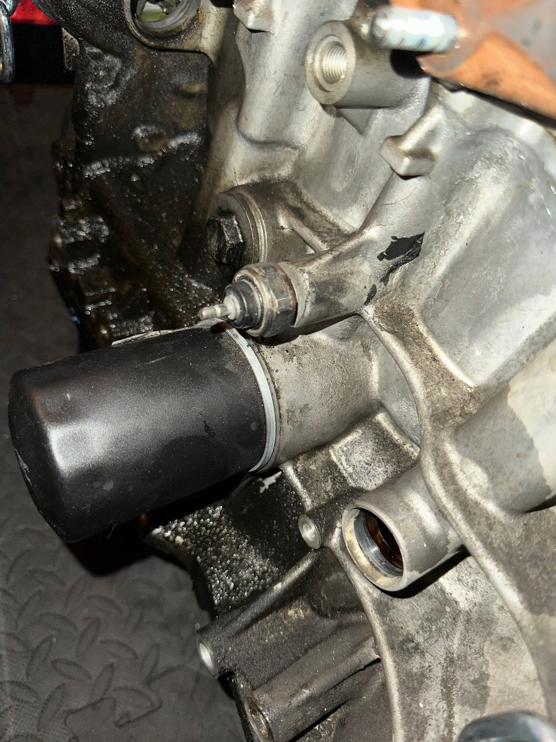

The sensor above the oil filter is my knock sensor? Not sure if I broke it taking the harness off 😢

Re: Engine acting up [solved?]
Yep knock sensor. You can put the torque converter back on the trans, just make sure it's fully seated

after looking at a few diagrams and digging a little deeper I’m thinking it’s an oil sensor. I don’t think this engine uses a knock sensor. There is an empty spot with threads but no sensor and no engine code

You are partly correct. That sensor above the filter is the low oil pressure switch. It controls the low oil pressure light in the cluster. You should still have a knock sensor. I think it's located on the same side, just further towards the transmission end.

had a machine shop / engine repair rebuild the motor. Ended up being a broken connecting rod on cylinder 3.
engine has all new parts block and head rebuilt. New valves, seals, pistons, rods, gaskets and timing kit etc.. Basically a brand new engine but with original block and head.
don’t have time to put it back in today but I’ll be working on putting engine and transmission back in a little each day.
