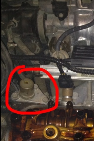

Re: Does a 1998 Honda civic SI have an EGR valve and chamber passage?
Is this the EGR valve? Click image for larger version
Nope, that's a VTEC solenoid
