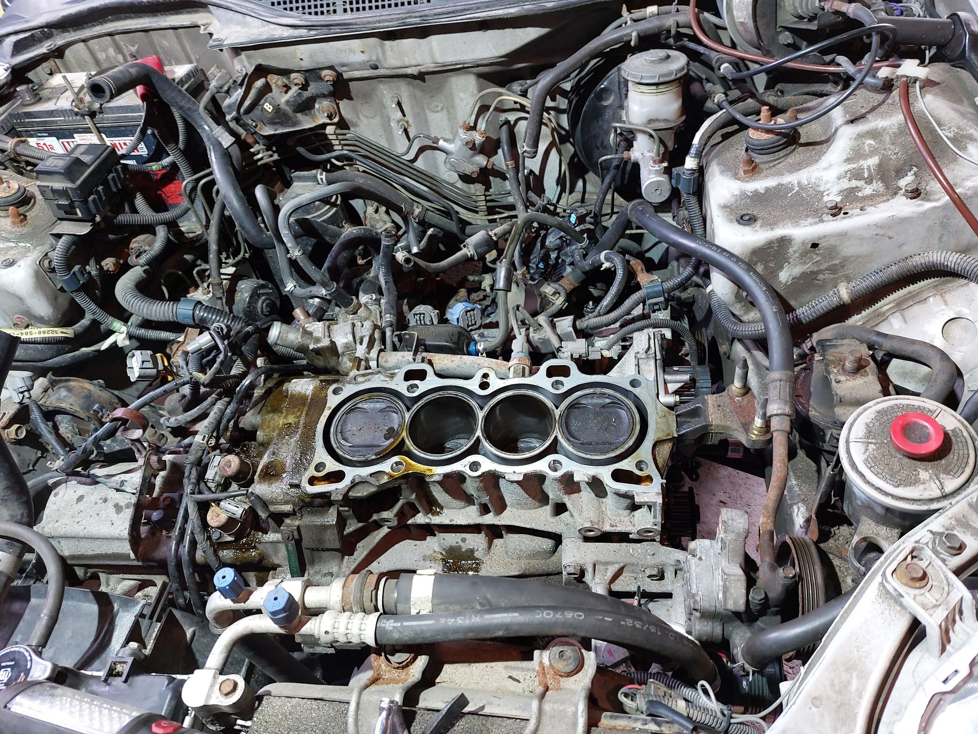

So it was the headgasket, wasn't really noticeable if the car was driven in town. Driving the car on the highway would make it worse. Driving home last night from the airport I stupidly forgot to check the level before we left. I hurt it bad. Going to see if i can limp it to where my tools are. Ordered the parts last night. Called the machine shop and they quoted me $160 to do the head.

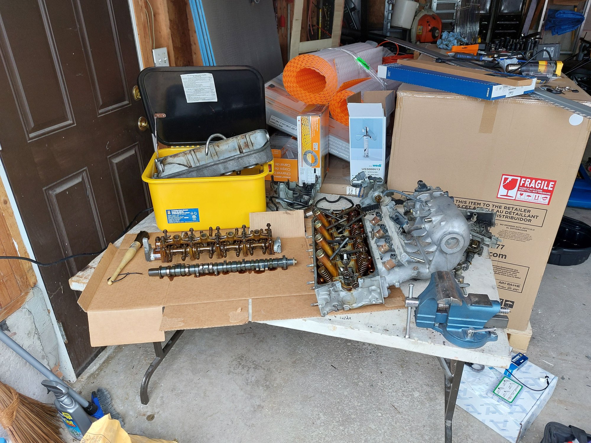

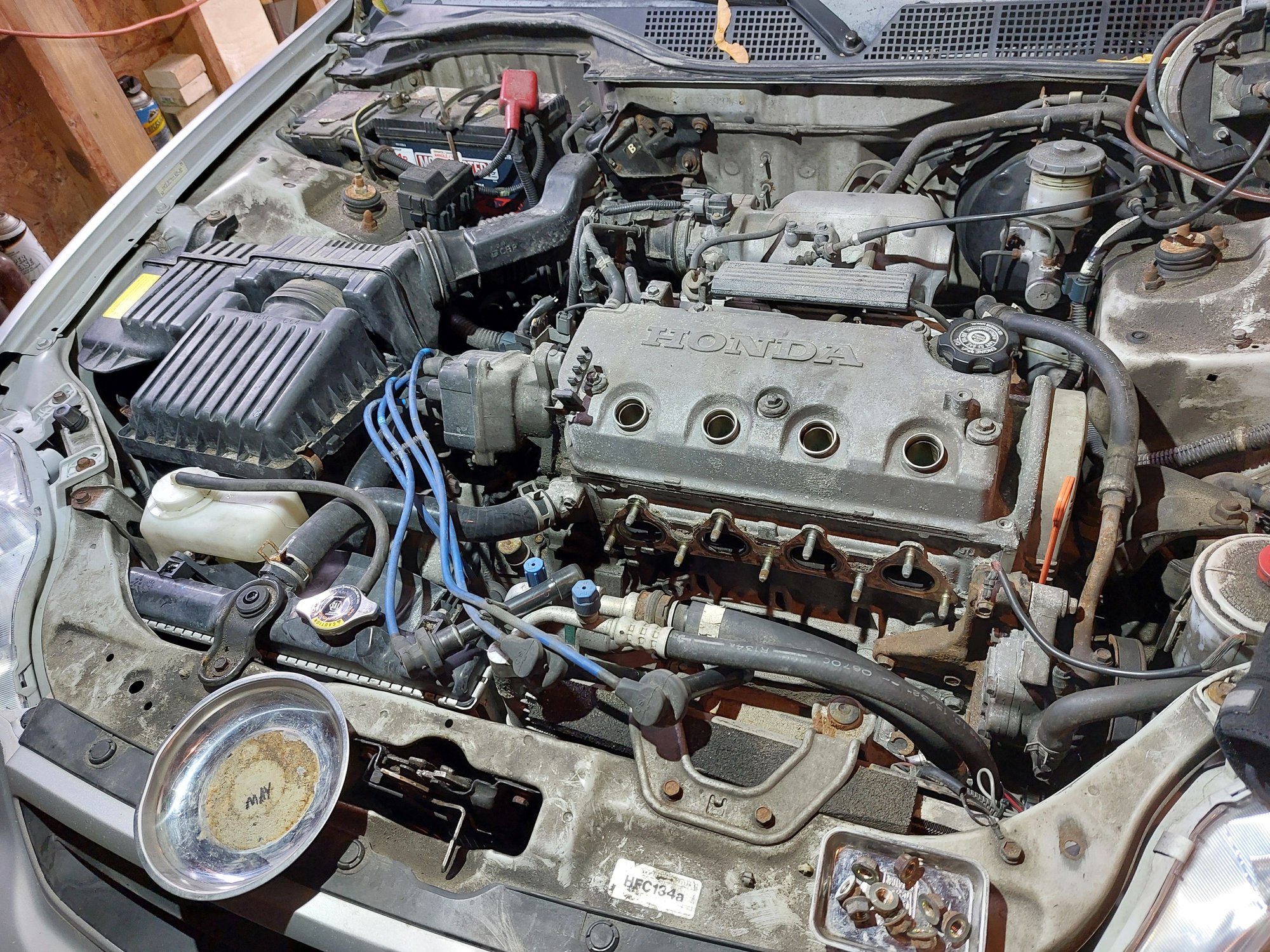

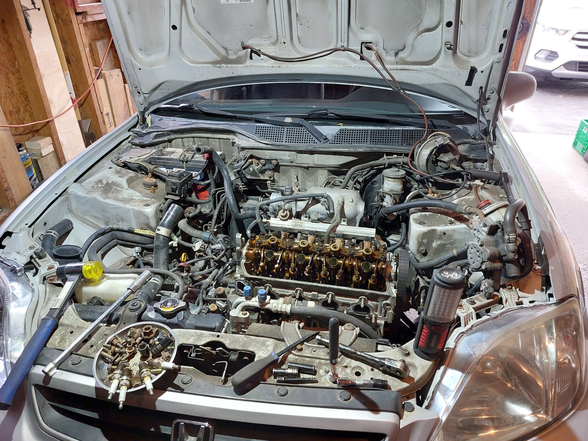

Ripped the car apart yesterday, head is at the machine shop now.
