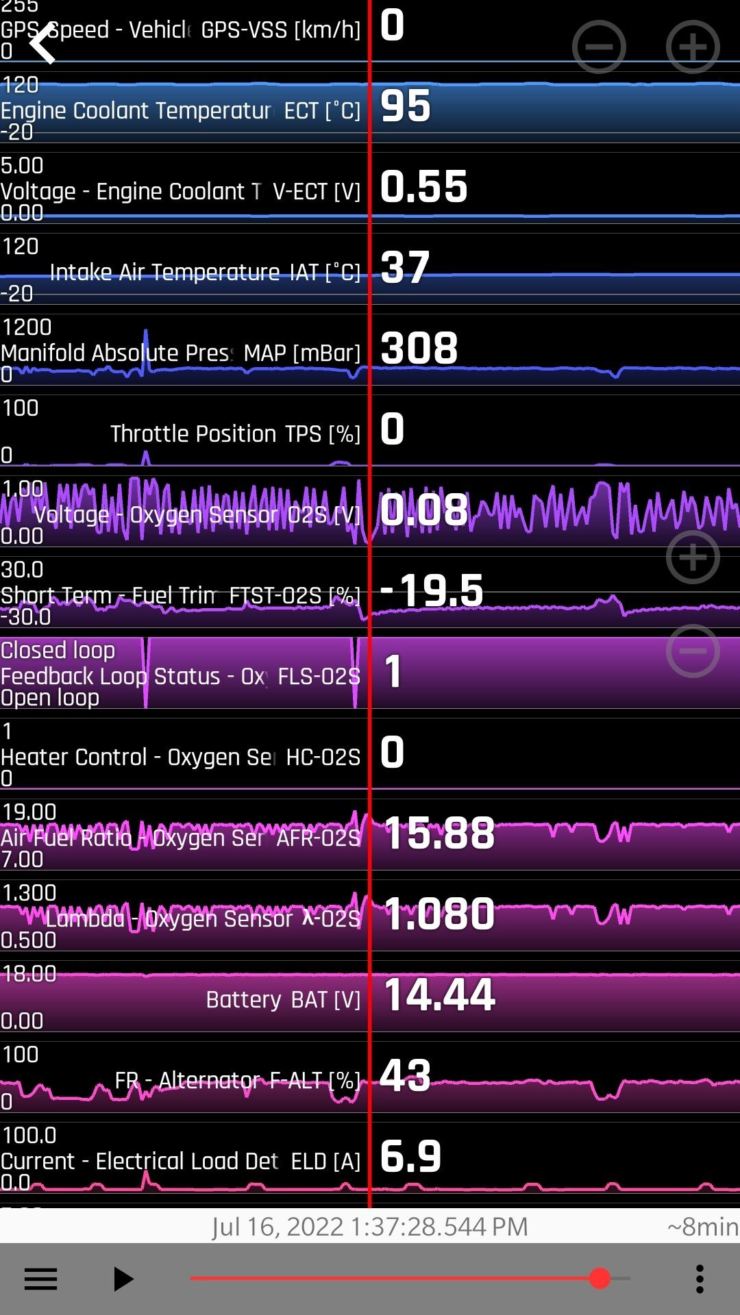

I haven't changed any of the sensors. I checked and they are in fact all plugged in correctly. I'm using a Hondash OBD scanner to check all the values.
In the log, you can see the small spikes on the electrical load which represent the times the fan kicked in, but the ECT graph is almost flat. By the way, the car is parked.
