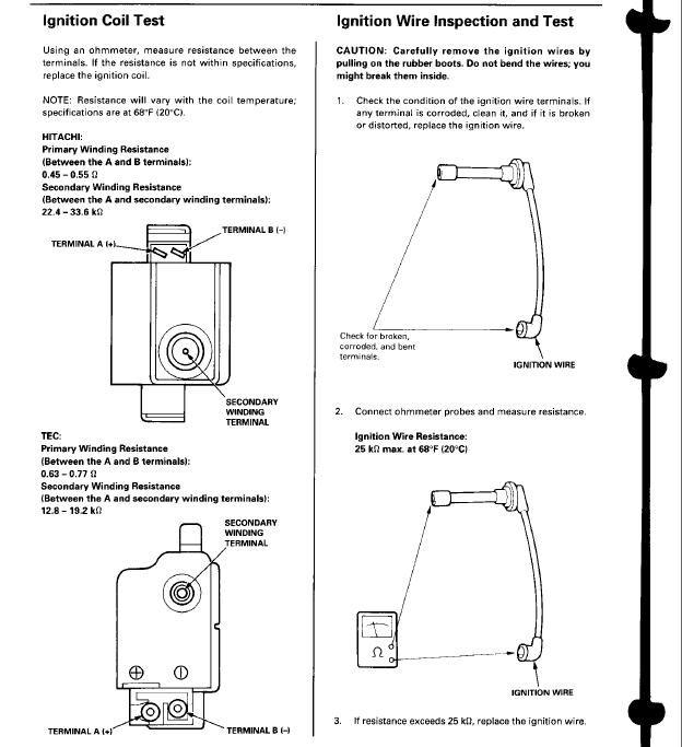

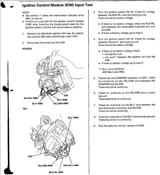

This may help: https://www.hondacivicforum.com/foru...uestion-80082/ and this https://honda-tech.com/how-tos/a/hon...-module-374873
I attached the images ICM (ignition control module a.k.a igniter) and Coil from the first link. Also, the best test for the coil is shown in the video below. You can use a long screwdriver to ground in place of the test tool ETCG is using in the video. I use one side of battery jumper cable to attach one clamp to long screwdriver and the other clamp to ground (strut tower's strut nut).
