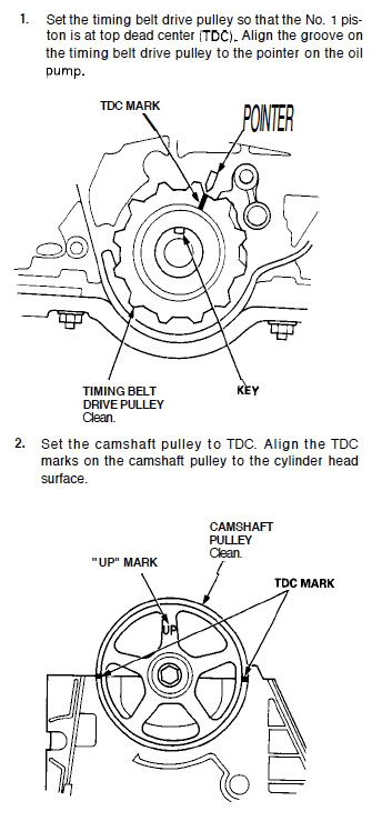

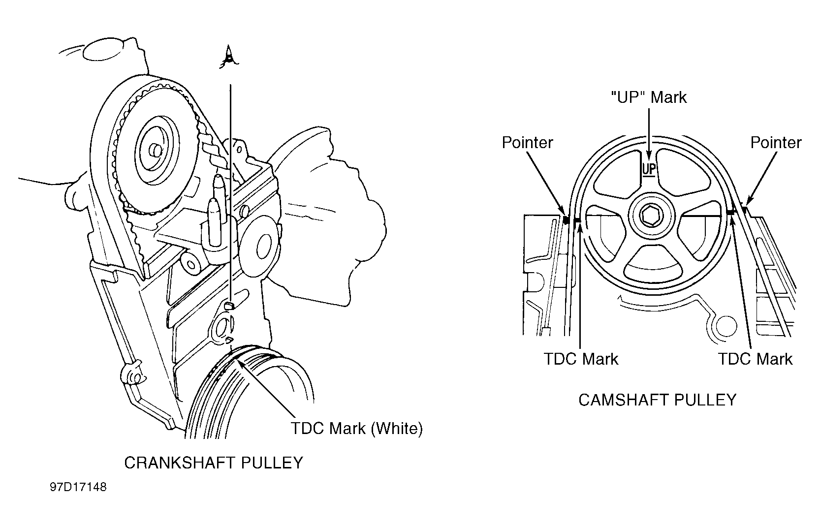

Just to clarify, after initially setting the mechanical timing on the wrong stroke you have now:
Set the number 1 piston to TDC on the proper stroke, aligned crank timing gear with arrow on the block (show in pic below), Aligned cam gear marks parallel with cylinder head (shown below)?
I hoped you used the service manual during the head gasket replacement. I also hope you used Genuine Honda (oem) MLS head gasket.
To find oil lleaks clean the engine as best as possible with Gunk engine degreaser or other brand and use a bunch of disposable rags to clean the engine. Afterwards start from the top of the engine downwards and track the leaks.
Did you try setting the distributor (ignition) timing the way I mentioned previously? If mechanical timing (cam and crank) is correct then this engine should crank and run temporarily whether or not the ignition timing (distributor) is advanced or retarded. However, for daily use and longevity the ignition timing has to be set properly as described in this link: https://www.hondacivicforum.com/foru...ustment-16210/
