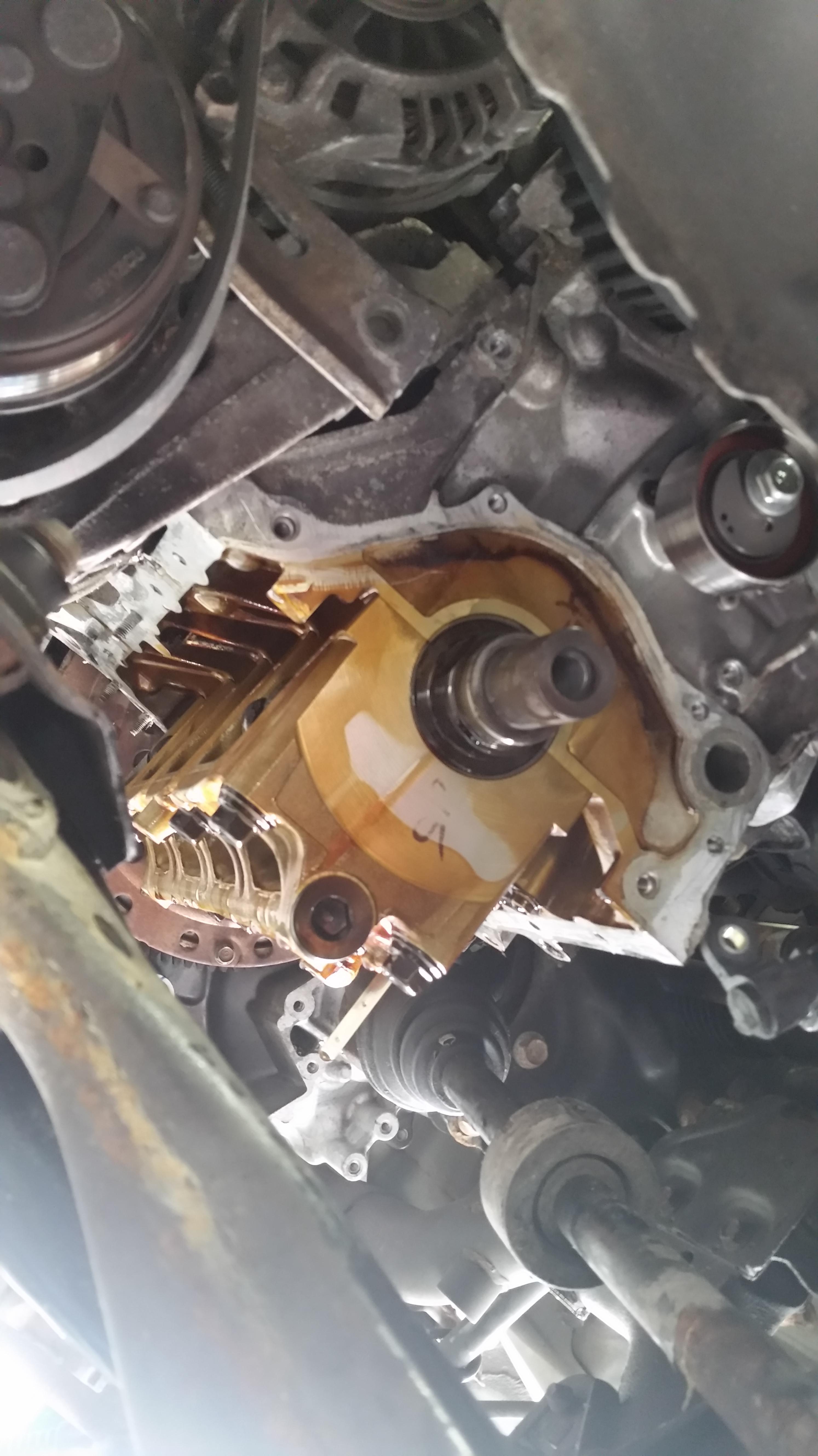

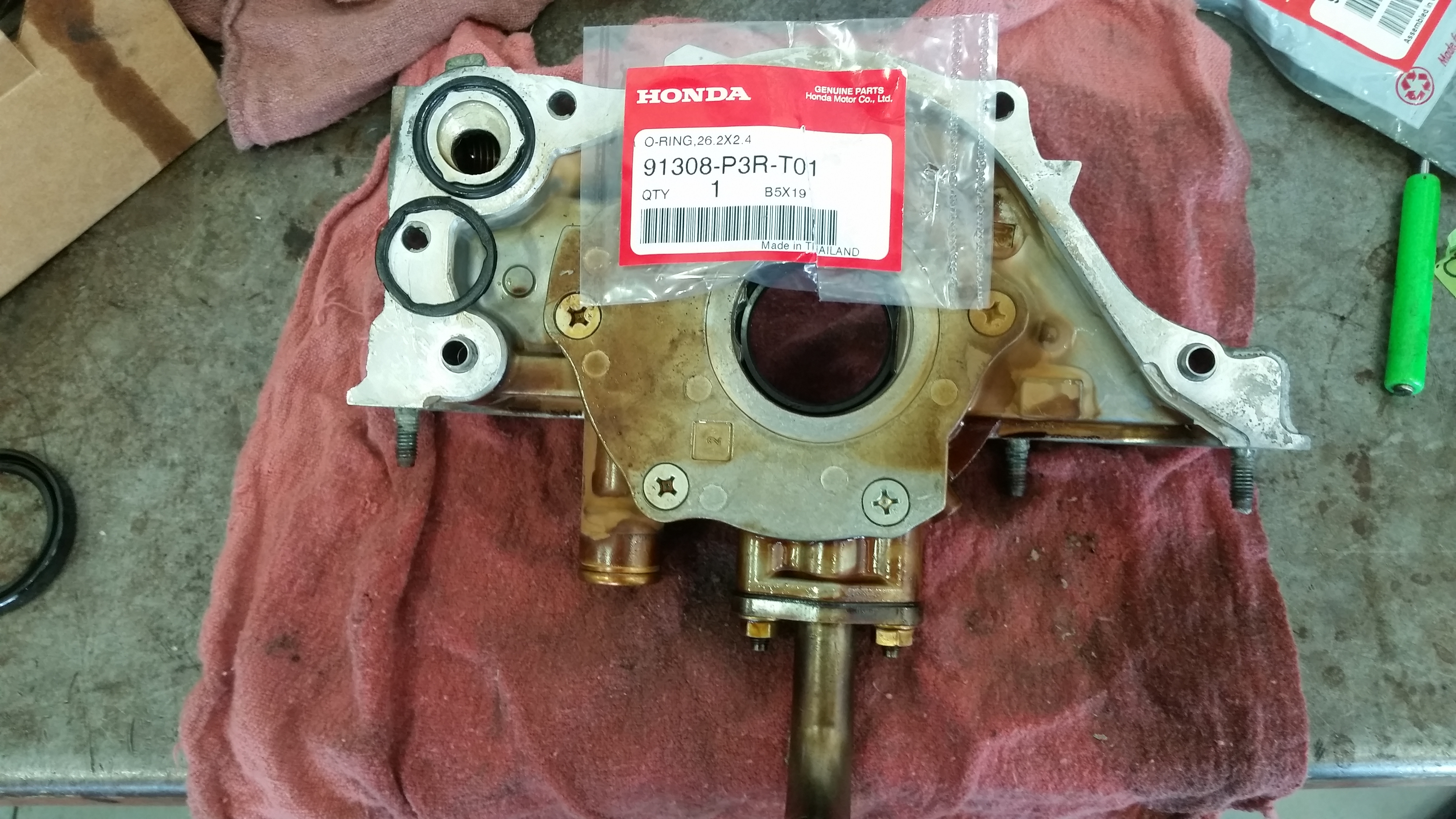

Re: Oil Leak
Handy pics of oil pump reseal job:
