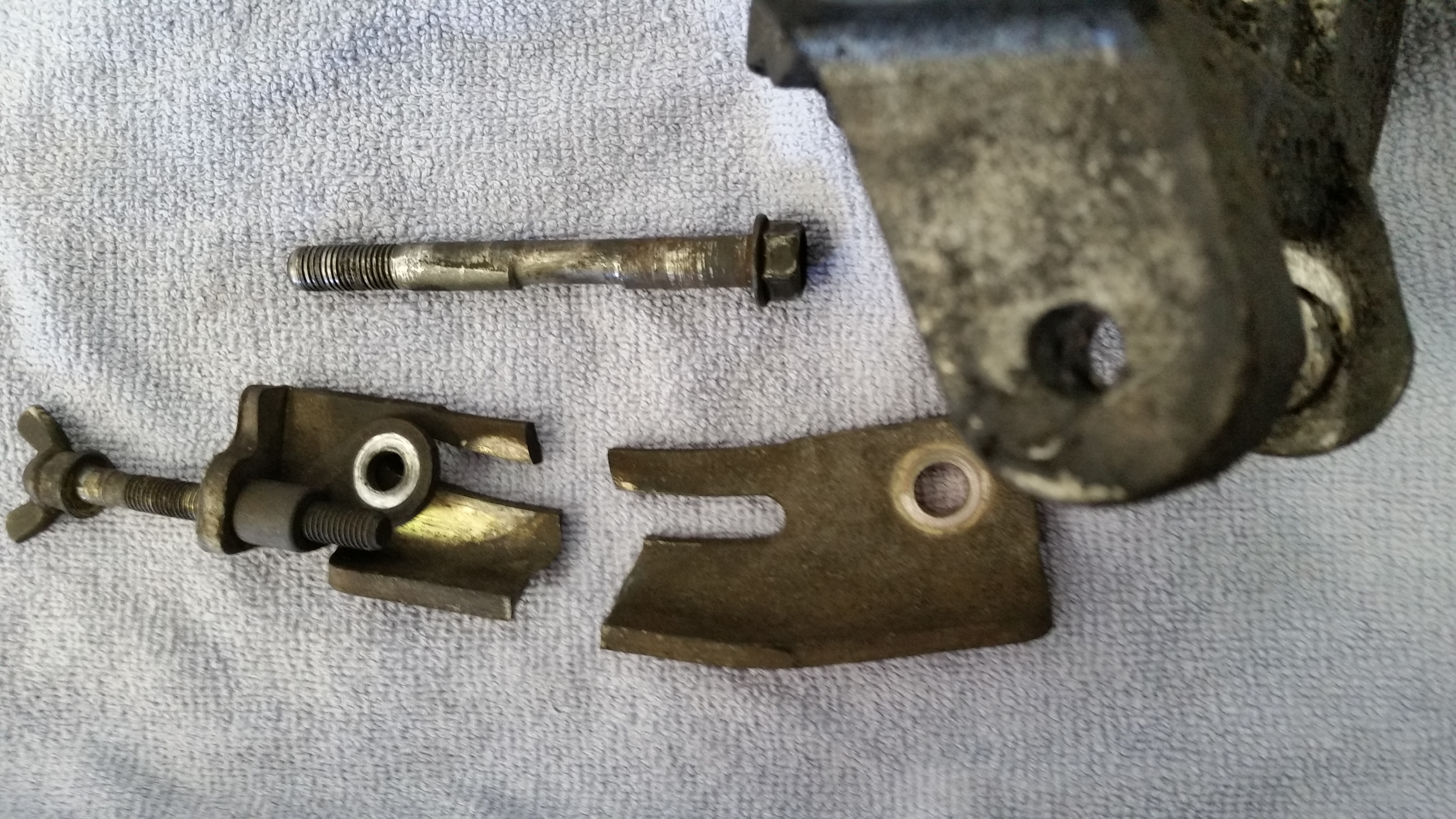

What can happen to the hard parts if the alternator was left loose for too long...bolt worn away, alternator was running crooked, bolt threads stripped out of the bracket and bolt, lower bracket broke in half....PLUS the PCM is fried.
(I'd never seen the lower bracket broken in half before this one)
