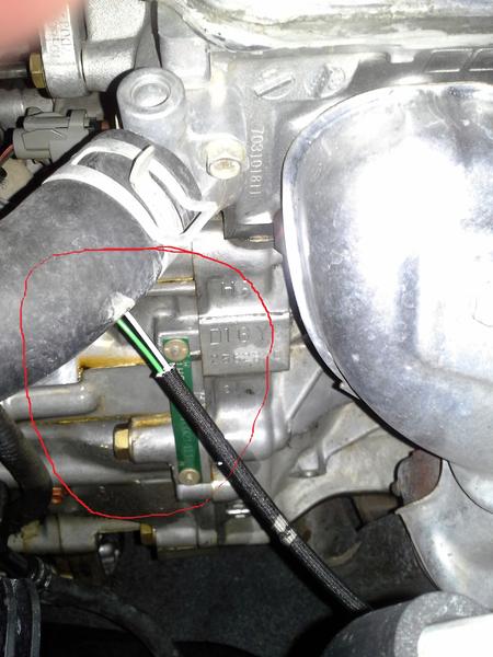

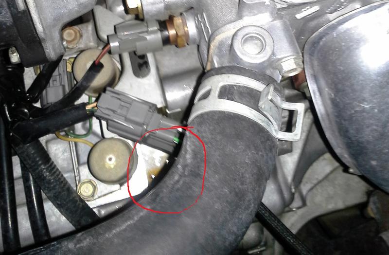

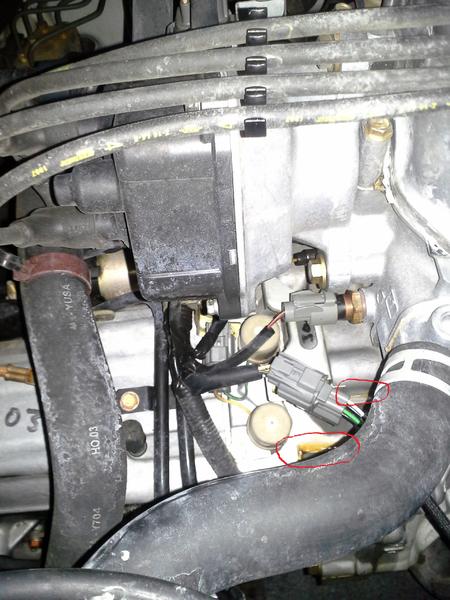

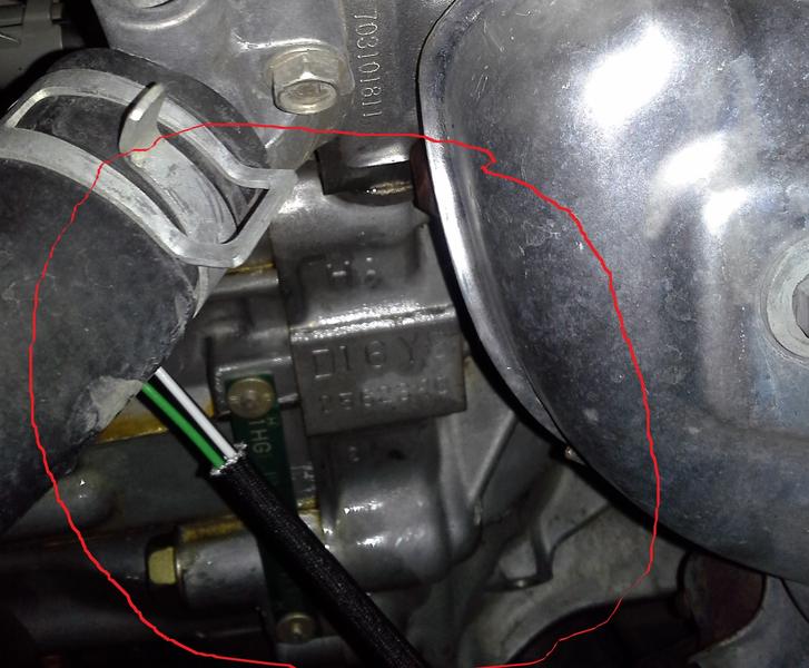

Ugh! Thought I had the leak stopped, but it ain't so. Valve cover gasket was replaced and dry, so that wasn't the problem, or at all of the problem.
Now I'm trying to figure out where it could be leaking from.
I understand that the distributor O ring is a likely culprit, but from my observations it appears to be dry in that area.
I've attached some pics. Hopefully some experienced eyes can take a look and offer up some ideas. Thank you.

Re: 97 EX, Oil Leak Questions
Feel under the distributor cap. If there is a drip hanging between the cap and the base, them remove the dist cap and look inside. It should be dry. I've seen them literally holding a pool of oil inside.
We've seen the front side, now scoot around to the back of the head and look.
The VTEC is about the only common thing left. It certainly can PUMP that much oil out in a very short time.
Clean everything spotless and throw white powder all over it, as I said in my first reply. This makes it incredibly easy to find the source.
All original rubber gaskets are suspect. They harden and shrink as they age with heat, miles, and time.
Especially the VTEC stuff because it has full engine oil pressure behind it.
The distributor does not have pressurized oil trying to get through its seals.

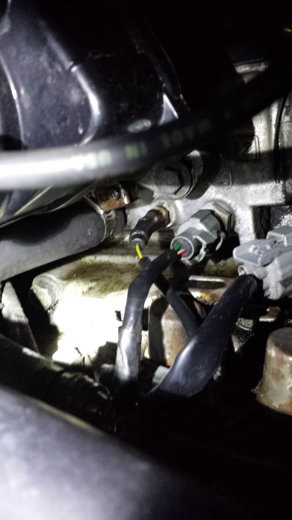

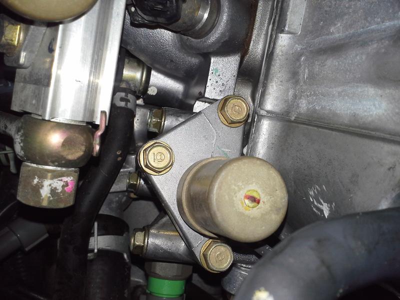

ezone, here is what I'm looking at. Is it simply a matter of removing the 3 bolts and replacing the gasket which I assume is sitting right there?
Is there another gasket that might be the cause of the leak while I'm mucking around in there?
Already covered:
Originally Posted by ezone
All of the 2 gaskets need done.

FYI, Honda does not show the horizontal gasket under the solenoid. Only the one that attaches the vtech assembly to the head. I was told by the honda guy specifically to NOT separate them. and the one gasket they show between the head and the vtech assembly is 23 bucks.
I show about $20 (USA), but yeah.
I ain't scurred.
Already addressed here:
I have to go back in time (to a 5th gen EX, 1995) to see the upper gasket in my parts catalog.
Someone else here in the forum actually bought this gasket for their 6th gen and reported back that it was correct.
36172-P08-015 is the part # for the upper gasket from a 95 EX
If the $8 gasket doesn't solve it, then you are stuck buying the $370 valve.
I know which one I'd try FIRST if it were me.
The top section (solenoid coil) has 3 bolts and anyone can take it apart. If it already leaks, it will still leak when you reassemble it if you don't get a new gasket. There are small parts that can be lost though, so you gotta be careful. If you lose anything, you will be buying the valve.

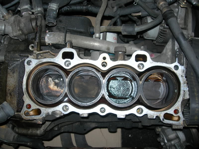

Without having that particular engine already torn apart to see what's actually in that area, I'll say that I THINK the only fluid in that area of the head gasket is coolant.
The oil pressure feed passage between the block and the head is usually between cyls 2 and 3 IIRC.
Did you have the camshaft out, or the cam journal caps off? If so, did you apply fresh sealant to the outer caps?
Can't find an actual pic of the correct engine with what I'm talking about, but this should suffice for the moment
This pic is a little bit excessive with the sealer IMO, but to give you an idea
This isn't the same engine, but you can see the fine red horizontal line of sealer between the head and the cam journal cap that is exposed:
ok, If I understand what piece you are talking about... I might have loosened them when I was trying to figure out how to replace my dizzy... but never pulled them off. just went out and checked with my flashlight, there is no oil at all near that seal... however the Vtech assembly is covered in oil and I KNOW I had cleaned it off completely when I changed its gasket. definitely looking for that 95 civic gasket tomorrow.
This is the oil that is sitting below the Dizzy.
when I did the head gasket I was certain that the oil passages were inboard like you were saying, between 1/2 and 3/4. just pulled a pic of the gasket and that is correct. so if the HG was leaking here it would be coolant not oil... here is a pic I found of the D16y8 block without a head...
Unless that hole in the lower front portion is an oil passage.
No biggie, I was just pointing out a spot that is often assembled incorrectly when head work is done.
The powder check would show if it was leaking, but I think you already found the real source.
the Vtech
There's no H
I think you nailed it.
Yes, a leaking VTEC set can let oil run across the top of the trans and go to the front.
The 4 large odd shaped holes----- 2 front lower corners and 2 on the intake side (top in the pic) between 1/2 and 3/4, those are return holes for oil to drain from the head down into the crankcase. Those have no significant pressure on them (drain by gravity only), they aren't a likely source of your mess. But yeah, I think coolant would be coming out of the #4 end first if there was a problem.
The only real pressurized oil passage is the small hole dead center on top between 2/3.
HTH
