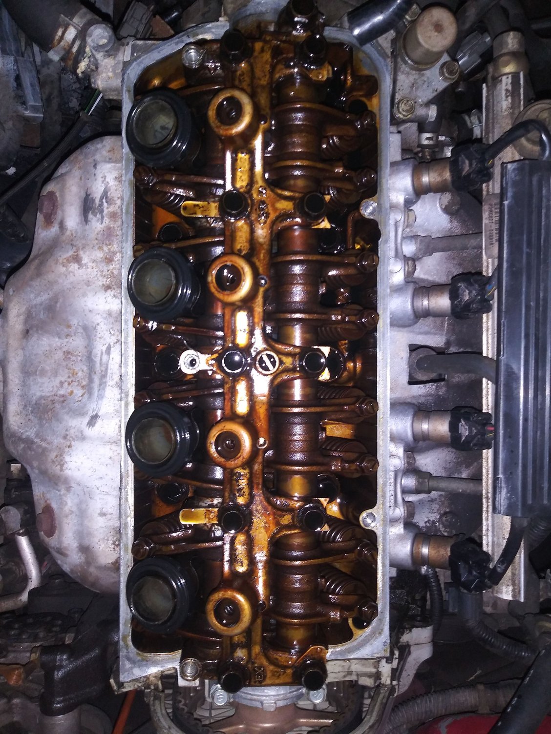

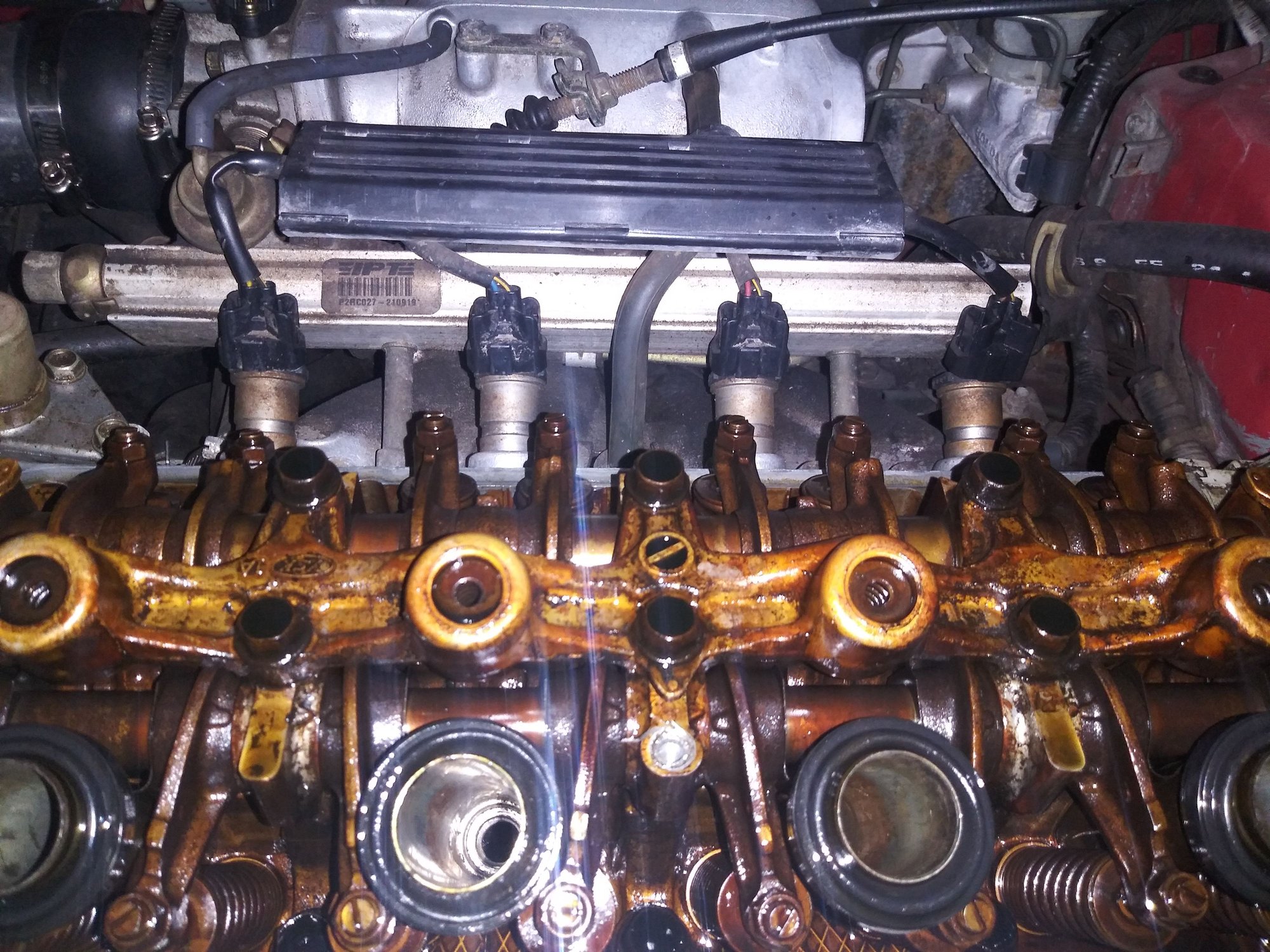

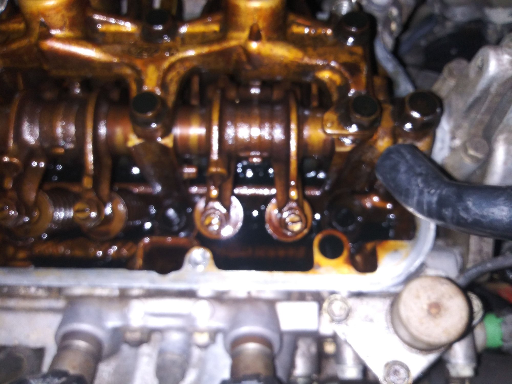

I didn't adjust the timing. My car now runs at like 500rpm and sounds like a diesel. The old rotor broke in pieces it was so old. The ticking is only on cylinder 4. I took the valve cover off and everything looks normal. I don't have a feeler guage or a odb scanner. I've done so much work on my car and now this happens to me and all I can think about is how ripped off I got on craigslist.
