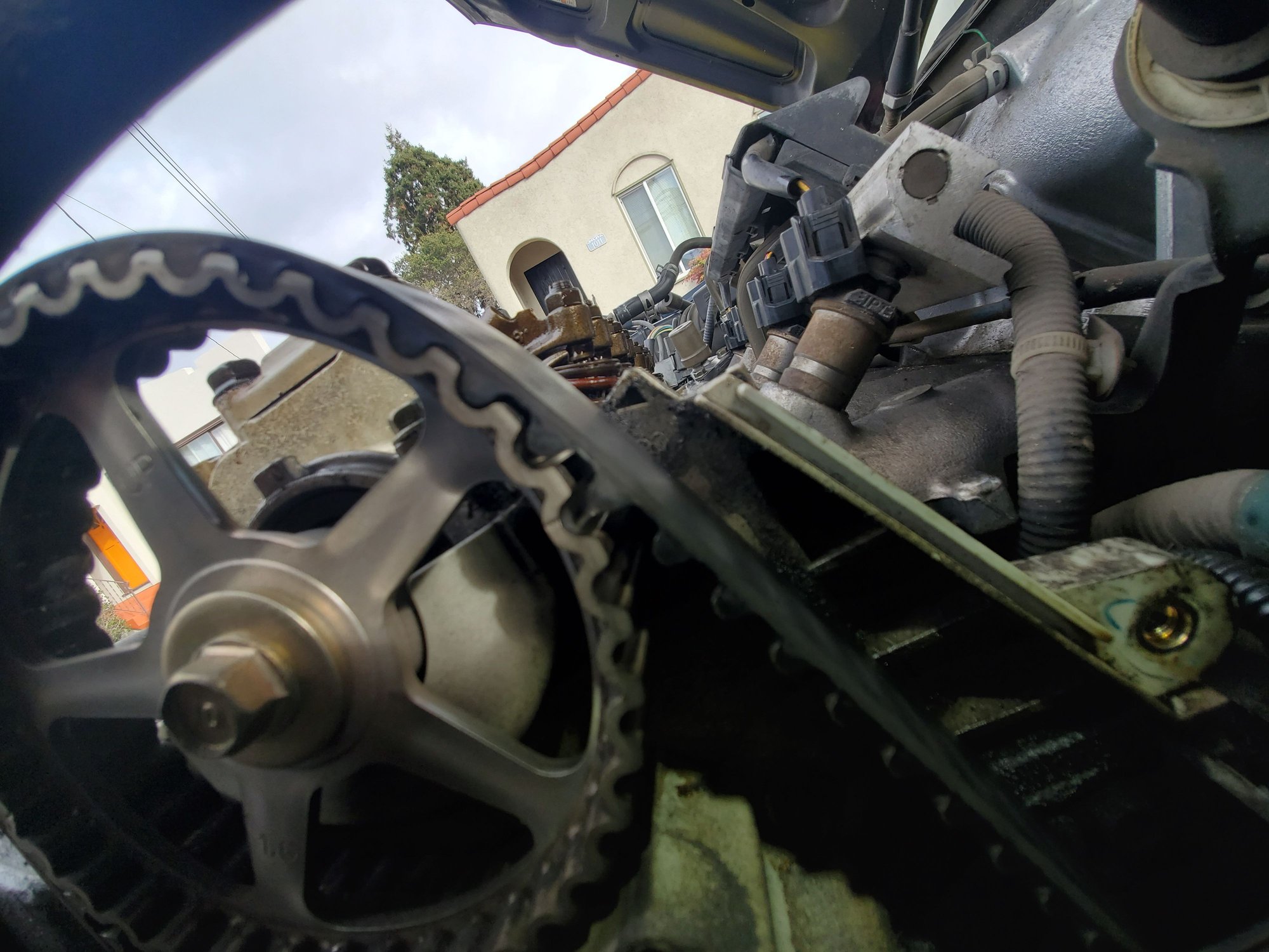

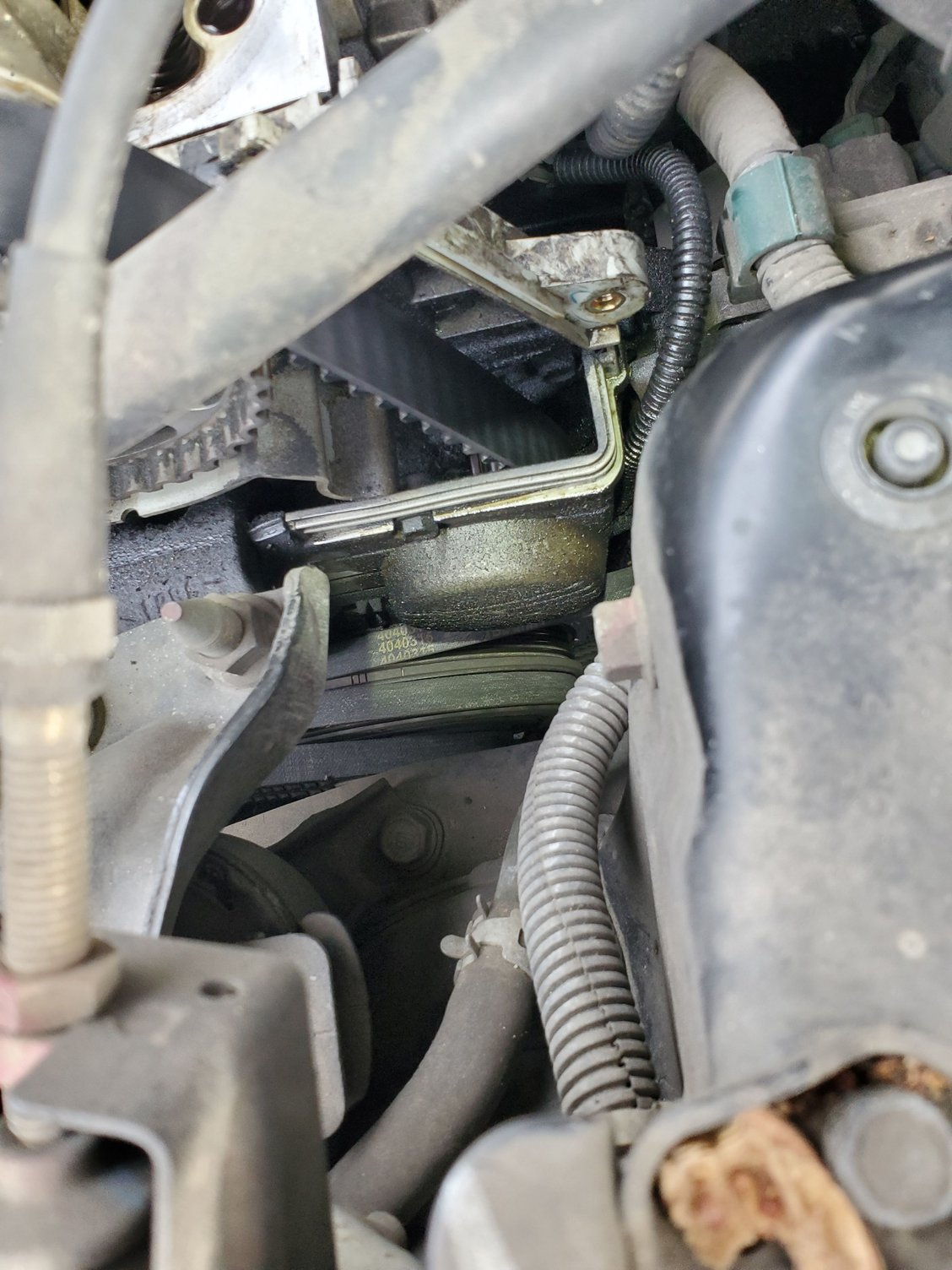

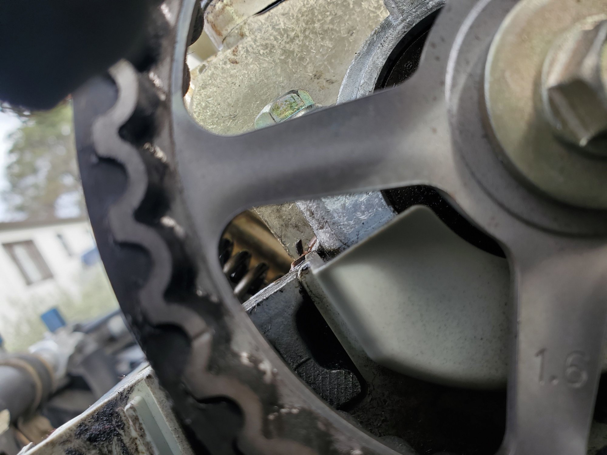

Checked mechanical timing. All is good. Pointer aligned with one notch on crankshaft pulley. Notches on cam are aligned with cylinder head. First piston is at top dead center.
​I'll have to check some videos on how to do the coil test. do you think there's anything else that could be causing the problem? Would it be the fuel injection problem that I never got to test? I do smell fuel after trying to start it, though. I guess I have to do a compression test and the othings you suggested. I tried to start it again, and it fired up once and then died almost immediately.
Pointer aligned with single notch. Couldn't get a good angle directly over it.
Notch aligned with head

Is the crankshaft mark really lining up? Picture makes it look like it's off.
I couldn't get a good angle with proper lighting to show them aligned. When one looks directly over the pointer, it is aligned with the single mark on the crankshaft.
