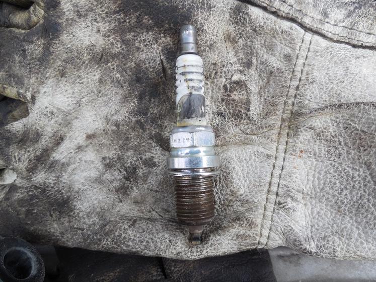

I pulled the plugs and one plug has a big black spot on the side of it down low with tracking spots as in that picture. Looks like this might to the answer I'm looking for!
Old Dec 7, 2014
Rep Power: 518
Re: 2000 EX multiple misfires returns after parts replacement. Twice.
Oooooo yeah that looks ugly! You should be able to see the matching tracks in the end of the plug wire mate.
The sparkplug socket you install the plugs with, make sure the rubber insert is clean and dry! (brake cleaner seems to work well for me)
Sometimes leftover dirt and grease can be the cause of the tracking, it gives the spark a path to follow.
I always thought NGK was a good brand of wire, even if they had a few issues. The blue color is just a plus LOL

Yeah, the tracking was gray on the boot. So far so good. Drove it up to temp a couple of times today and tried to lug it up hill where it used to sputter I think I felt a bobble once, but I'm not positive. The car has a load more power than I remember it having. I'm loving it so far.

The car's running great. You nailed the diagnosis.

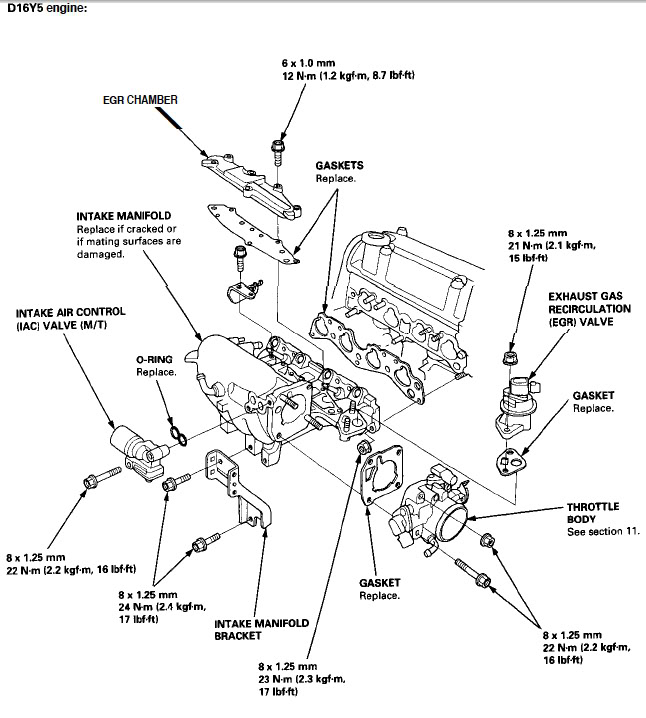

IDK enough about your engine to do any better at this.
If your intake manifold is like this one in the picture, you can see where the EGR valve should be. Unplug the wiring connector from the valve and drive it for a couple days or however long it takes to decide if it helped or not.
If disabling the EGR valve helps the situation with the stutter and shake feeling, then the EGR chamber probably needs removed, clean out the passages of carbon debris, clean out the gasket, and clean out the holes in the intake manifold runners where the holes in the gasket are.
HTH
If your intake manifold is like this one in the picture, you can see where the EGR valve should be. Unplug the wiring connector from the valve and drive it for a couple days or however long it takes to decide if it helped or not HTH
There want really any noticeable difference, but I cleared the codes on the car again and started it back up and almost immediately, the light came back on. I put the computer back on it and it came right back up with cylinder 2 and 4 misfiring
