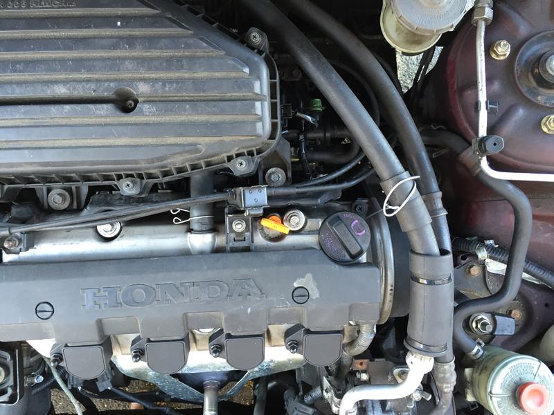

What the heck happened or caused these bolts to go off the mount(may be)??

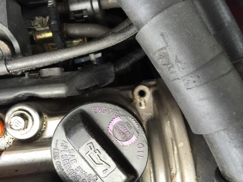

Old May 13, 2015
mrohitredd's Avatar
Joined: Aug 2013
Posts: 121
mrohitredd is an unknown quantity at this point
Re: Weird Vibration after HeadGasket replacement.
Here a another one

the first picture with the oil cap and valve cover, it looks like you are missing a bracket that secures the A/C line, this is not a huge deal, but should be replaced,
the second picture is very scary....WTF?....that motor mount is not secured properly...or at all, that needs to be addressed ASAP,
***EDIT***....wait a minute, you just had the head gasket replaced?.....holy crap that shop F-ed up big time that motor mount is why your engine is vibrating, somebody forgot to re-attach this....sorry to say this, but what a garbage job they did
I don't see a problem here. Can you point it out?
The open bolt hole in the corner of the valve cover is not used on this application IIRC.
Or maybe it is and I can't remember it.

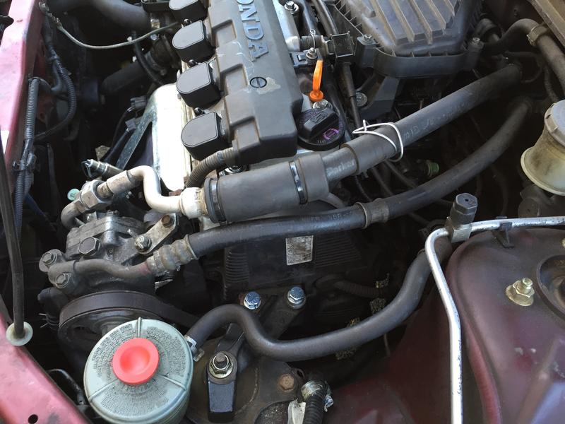

Next pic:
Can you turn the pic right side up? My cat is looking at me like "WTF?"
HOLY POOP they broke the studs off from the mount bracket!
That ain't just loose, that's BROKE THE F*** OFF!
I'd guess someone hammered them with an impact gun until they were far too tight.
Makes me wonder about everything else that was touched.
SOMEONE owes you a correct fix for this.
If someone can get the broken stud pieces unscrewed out of the bracket, the studs are available separately.
90380-S10-000 is the part number for the studs, you need 2 of them.

Pic 1 - that was for the screw holding AC clamp. I saw that the clamp was off (may be it cudnt bear the vibration from the motor). They put a new one & looks fine now.
Pic 2 - not sure what exactly happened, they screwed up the mount screws. When I asked them about the vibration, you know what he said (bad fuel)... Anyways, they installed new bolts and I feel that it's secure. No vibrations what so ever.
AC - probably the free ons is low. I'll drive.and check the car for couple weeks and then I'll fix them all together.

Pic 1

Pic 2

the coat hanger they wrapped around your A/c line is a bit sketchy, but i guess could do
if the engine mount is secured properly, then i guess it should be okay, impossible for me to tell with pics though

After seeing all the damage done so far, I'd say to go back and ask "Mr. Goodpliers", the one that thinks it's OK to use coathanger to replace a missing bracket. See if you get that answer of dirt in the fuel again.
