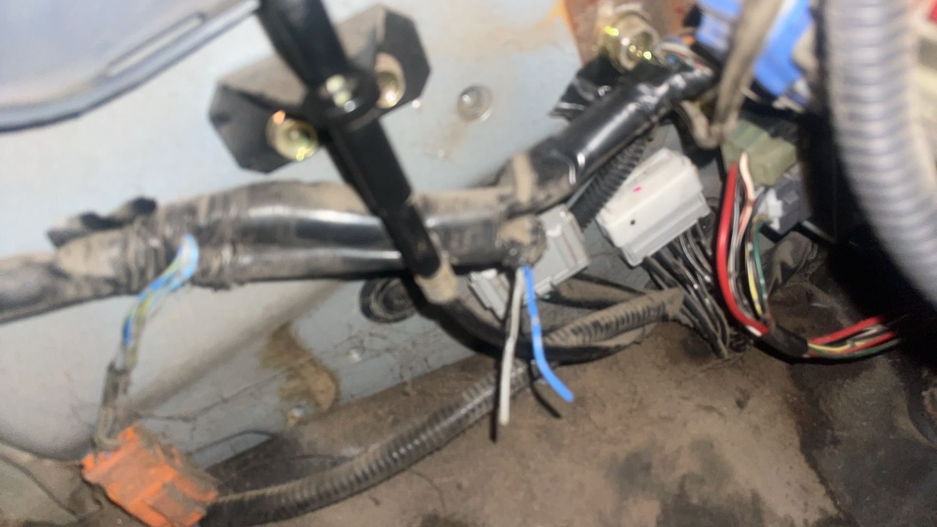

Just random cut two wires just below my fuse box in my interior. Do you think this could have anything to do with it?

No clue. Try doing a continuity check
