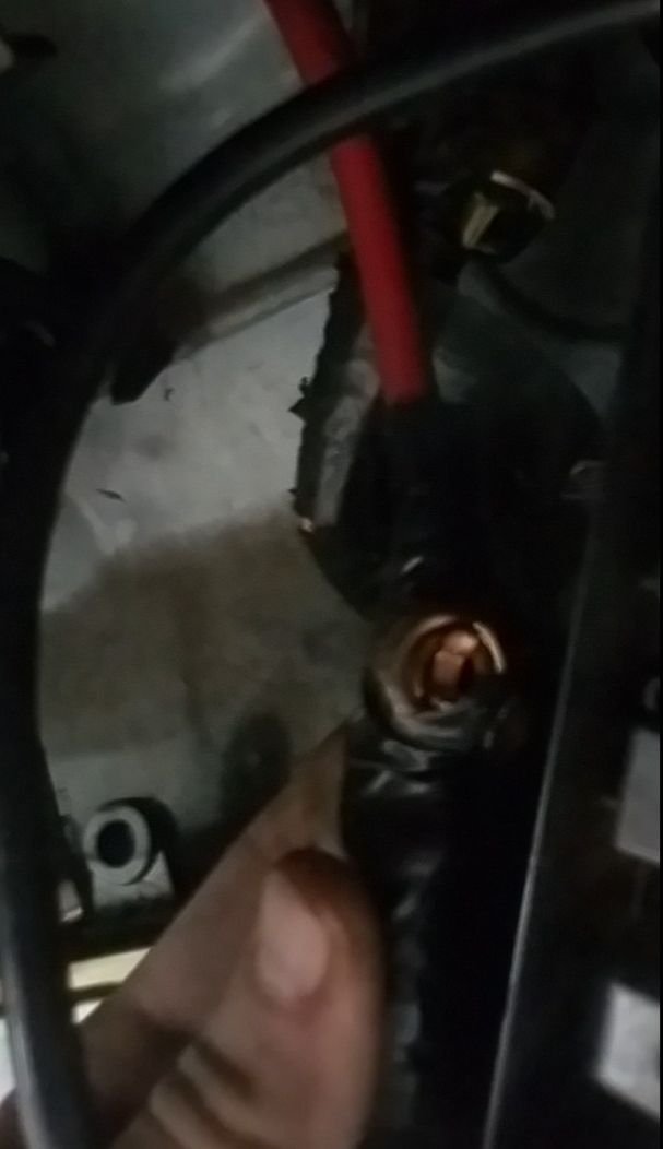

I pulled the trim and carpet and I did not find a fuse, however, i did find THIS (see attachment) going under the dash coming from the same battery cable. I put the multimeter up to it and it read, I didn't write down how it read. So, should my next step to look at my ecu/ECM or tear down the dash and follow this?

I oriented the picture to match the orientation of the cord going into the dash.

I would figure that wire out, it doesn't look factory

no its attached to the relocation kit I mentioned prior

Which isn't factory, there might be a fuse hiding or a sketchy connection along that wire

I believe that is a "sketchy connection along that wire". Looks like the a cable for the relocation kit was too short and they had to add on? Bare copper showing on a battery connector flopping around under the dash is bad.
