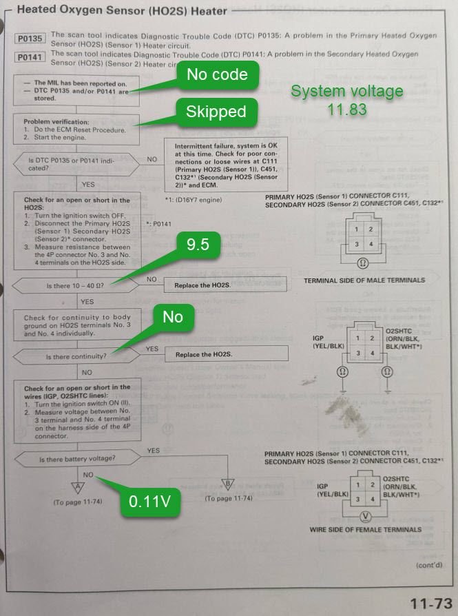

1996 Del Sol Si 491k miles D16Y8. Failed CA smog check. No OBD2 codes. Runs well.

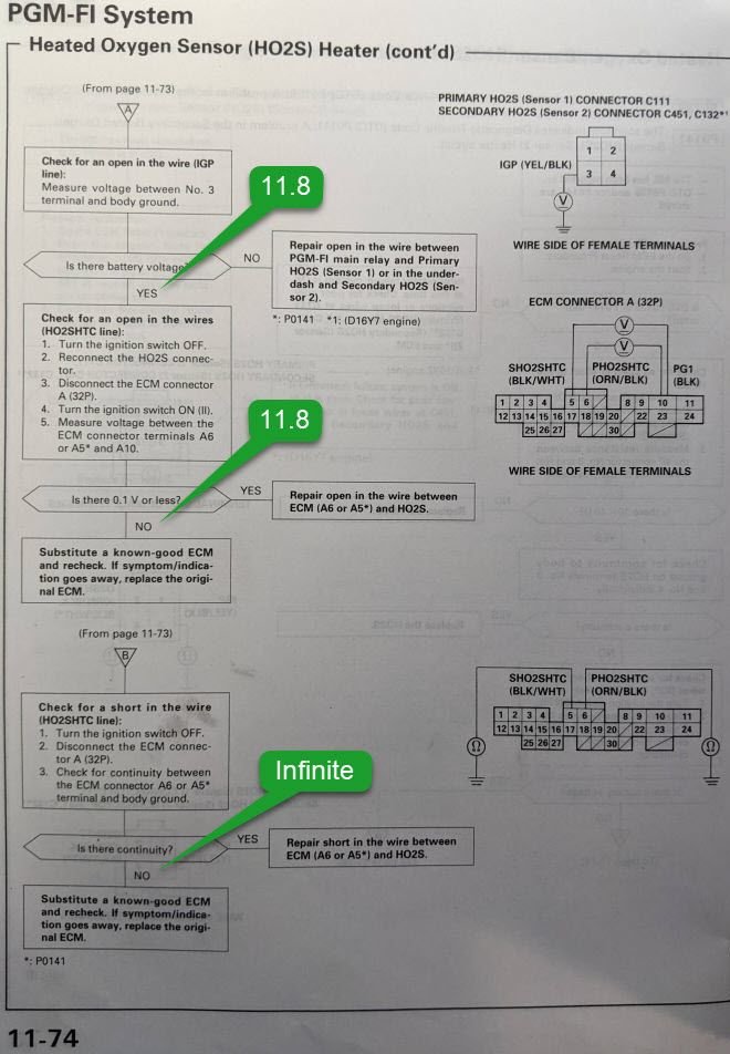

I suspected a bad primary sensor heater so I went through the FSM procedure and you can see the results below. I did not reset the ECU as there were no codes. It appears that the ECU is not grounding either of the heaters.
I inspected the circuit board and found no visibly damaged components. I pulled the connectors apart and jumpered all pins through except the heater ground which I ran though the meter and read zero amps. I plugged it back in and used a inductive current meter and again measured no current. I verified all functions of my Fluke 77 meter and current clamp.
Does this really mean the ECU is bad or could there be something I am missing? Has anyone experienced a ECU failure like this?
Also I'm open to any thoughts on where to look first to fix the smog test failure.

Update: The FSM specifically states to turn the ignition switch to the "On" position and there is no voltage. However when I turn the engine on, I measure current. The heater is not the problem.
What made me check this is that I've read in a few online posts that the ECU only closes the ground circuit when there are no codes and the engine is running.
Is the FSM wrong?
Also I have measured the resistance of the other heater element which I replaced with aftermarket at the same time long ago and it's 13 ohms. That's in spec but the primary sensor is 9.5 ohms. Is only 0.5 ohms bad enough to cause a problem? Wouldn't that just make it hotter?

The smog results are in the photo in the OP.
I replaced both the O2 sensor 2016/05/18 with a Bosch 13007.
