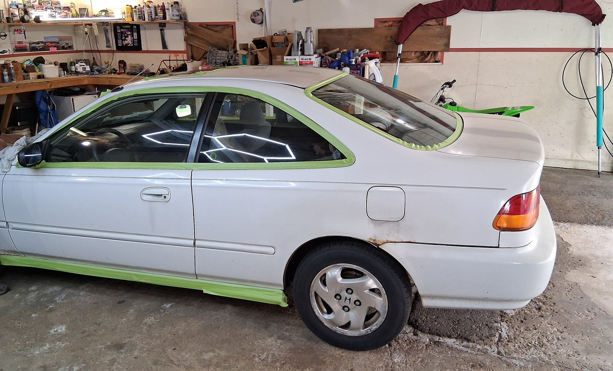

Did a little Body Makeover. Still undecided on which cat-back to get and whether or not to get the 1320 UEL Headers coated or leave them raw. Now for before and after pictures of the body makeover.

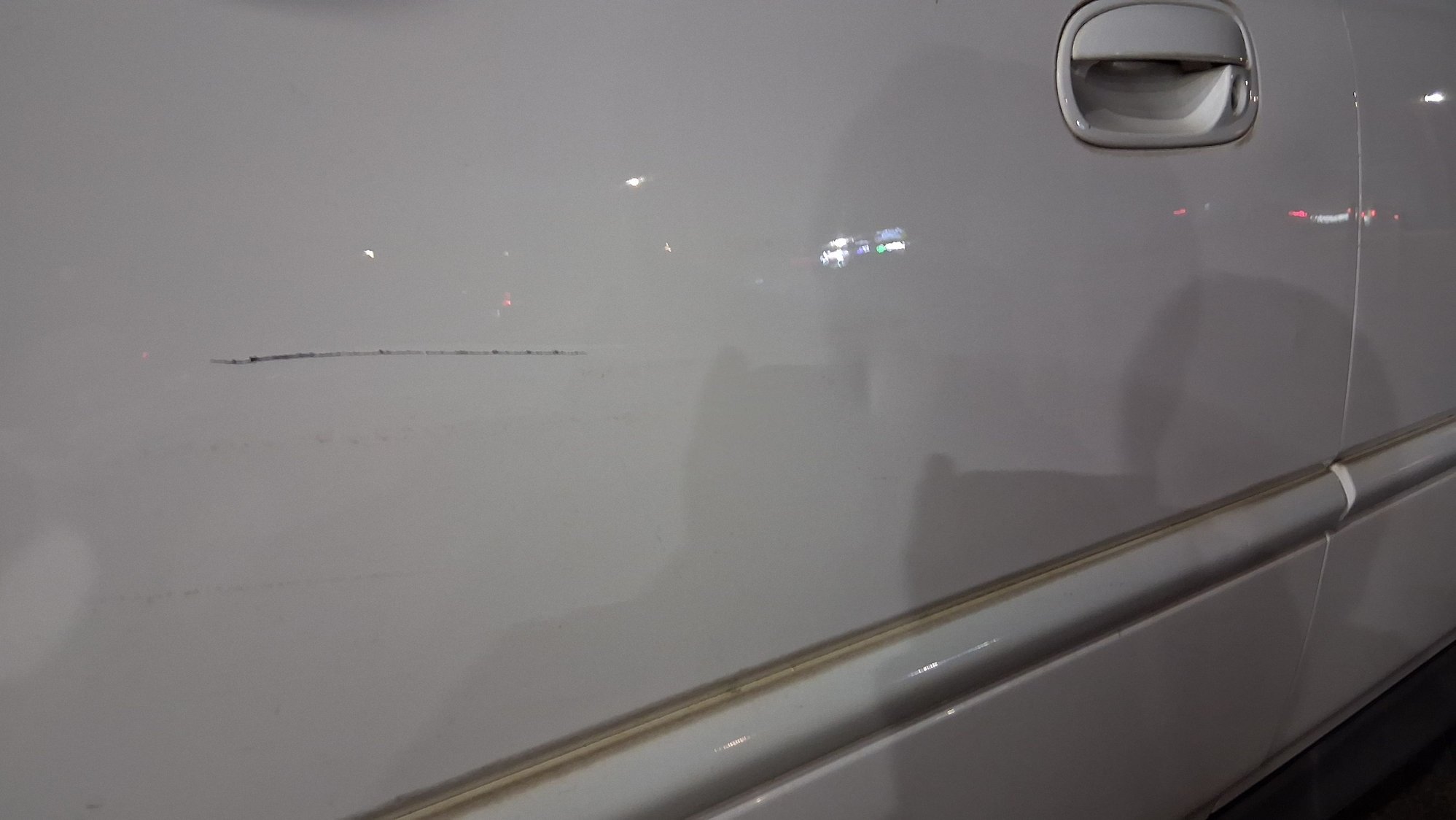

Ran out for some Arby's and on my way back home a deer hit the driver door and mirror. Disconnected the mirror and left a nice gash, scrape and dent on the driver door. Thank you November.

You're lucky it wasn't a lot worse. I grew up in a pretty rural area but tons of cars were written off by deer in the winter. My FR-S almost got totalled after an incident a couple years ago.

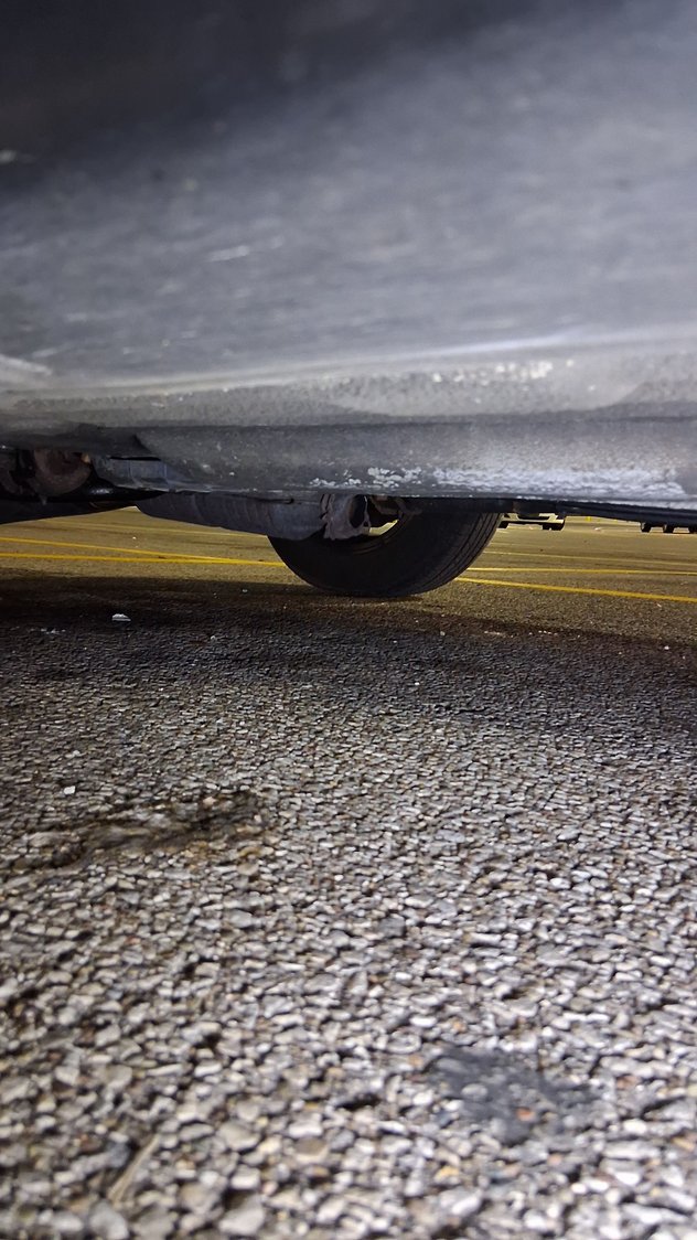

New update too. The exhaust...has had it.
Video of what it sounded like when it started to go...
https://drive.google.com/file/d/1G4S...ew?usp=sharing
...when it finally broke...
https://drive.google.com/file/d/1h8g...ew?usp=sharing
Broke right after the converter.
Getting a temporary fix by a local exhaust shop so I can keep working until I can save a bit more for the new exhaust overhaul. 1320 UEL Header, Magnaflow 53956 Catalytic Converter and Magnaflow 15646 Cat-Back Exhaust. Looking for a quiet cruise with a scream at WOT. Magnaflow usually mixes the two well. Really curious what the UEL Header will do for the Magnaflow tone overall. Hopefully update in the next few weeks about the exhaust. I will be getting the Header and collector Jet-Hot Coated as well and will post the cost. I remember my Camaro headers and collector being about $300 for the pair...about 8 years ago. Next after exhaust I really have to get this timing belt overhaul done. It's going to be a really big project and encompass a lot of new parts especially the motor and torque mounts as well as a crank pulley but the big part being I need to buy some new tools to get all this done too. Still no garage or driveway to work in atm. Slowly we'll get hammering on this car. I have quite a bit of work ahead of us and we'll tackle them as needed first.

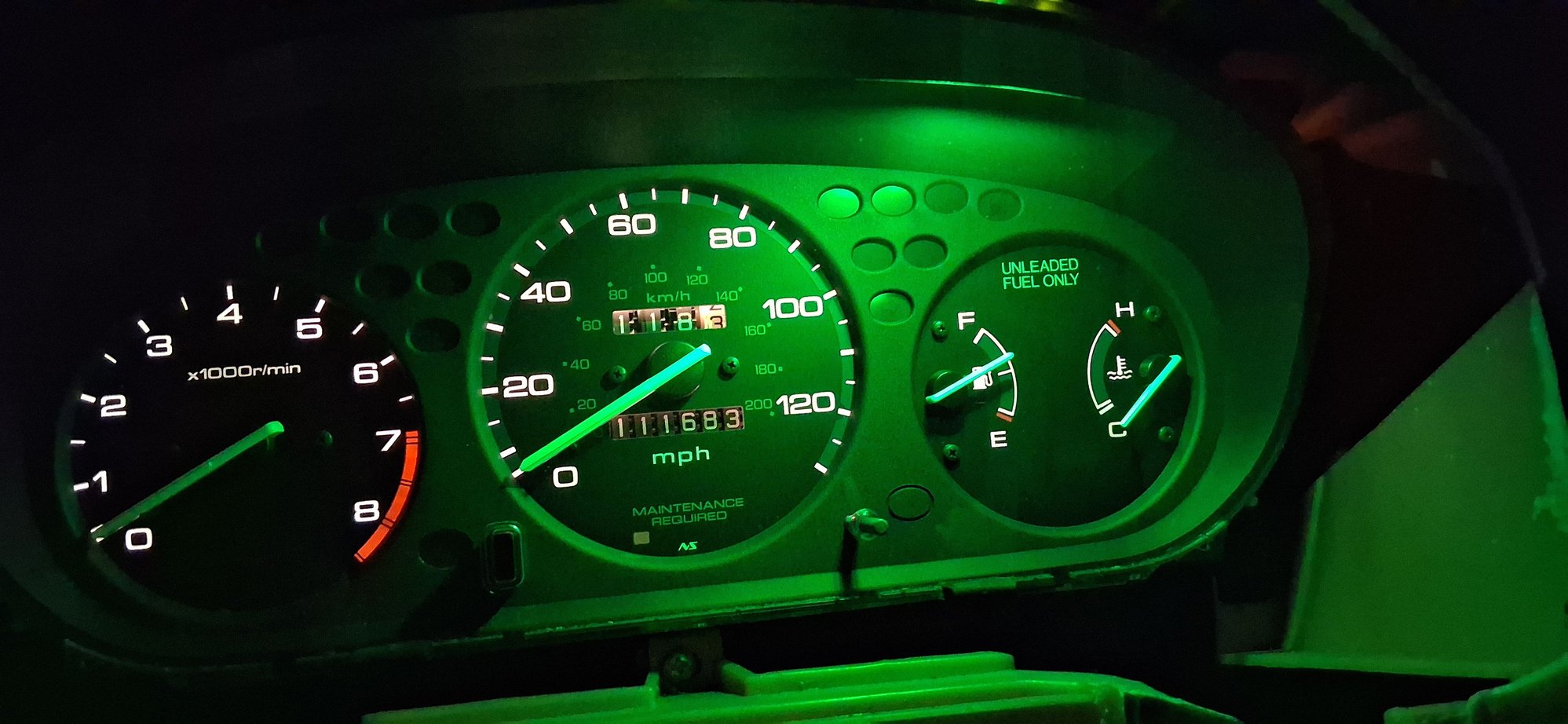

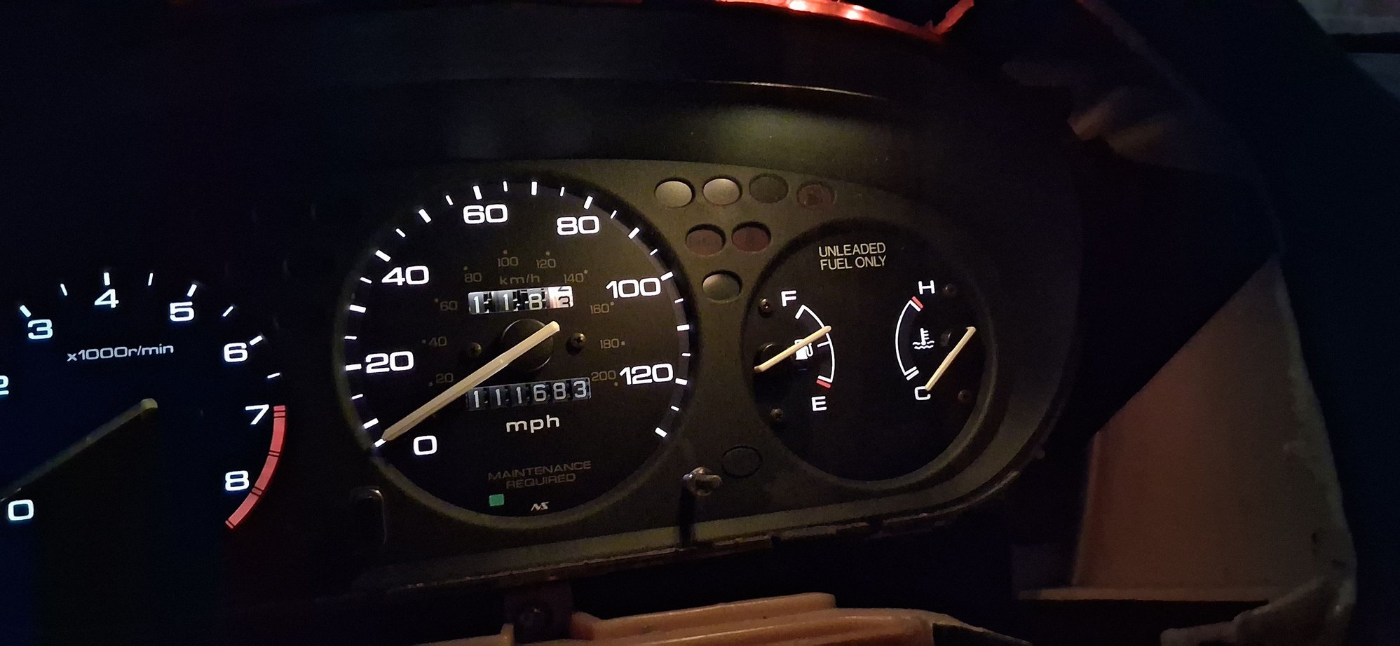

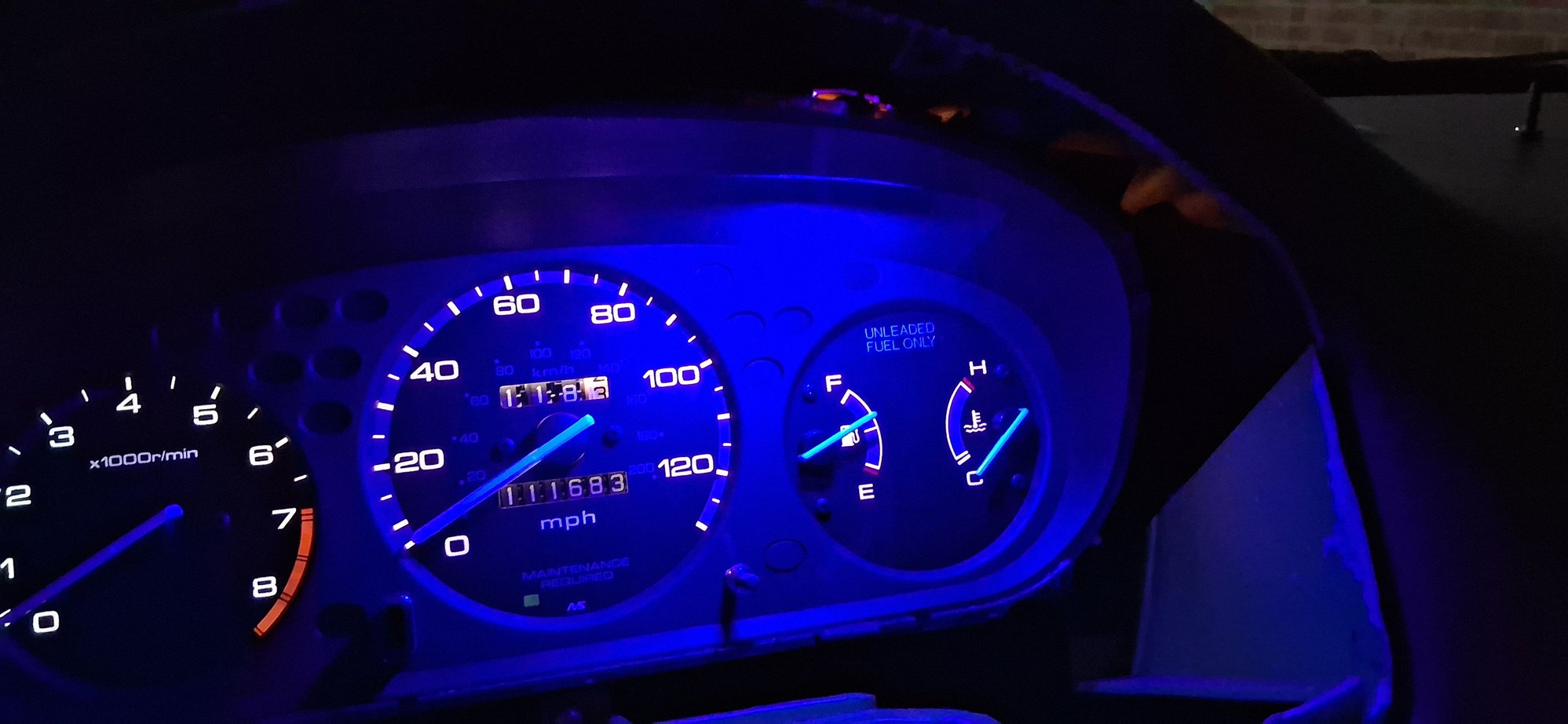

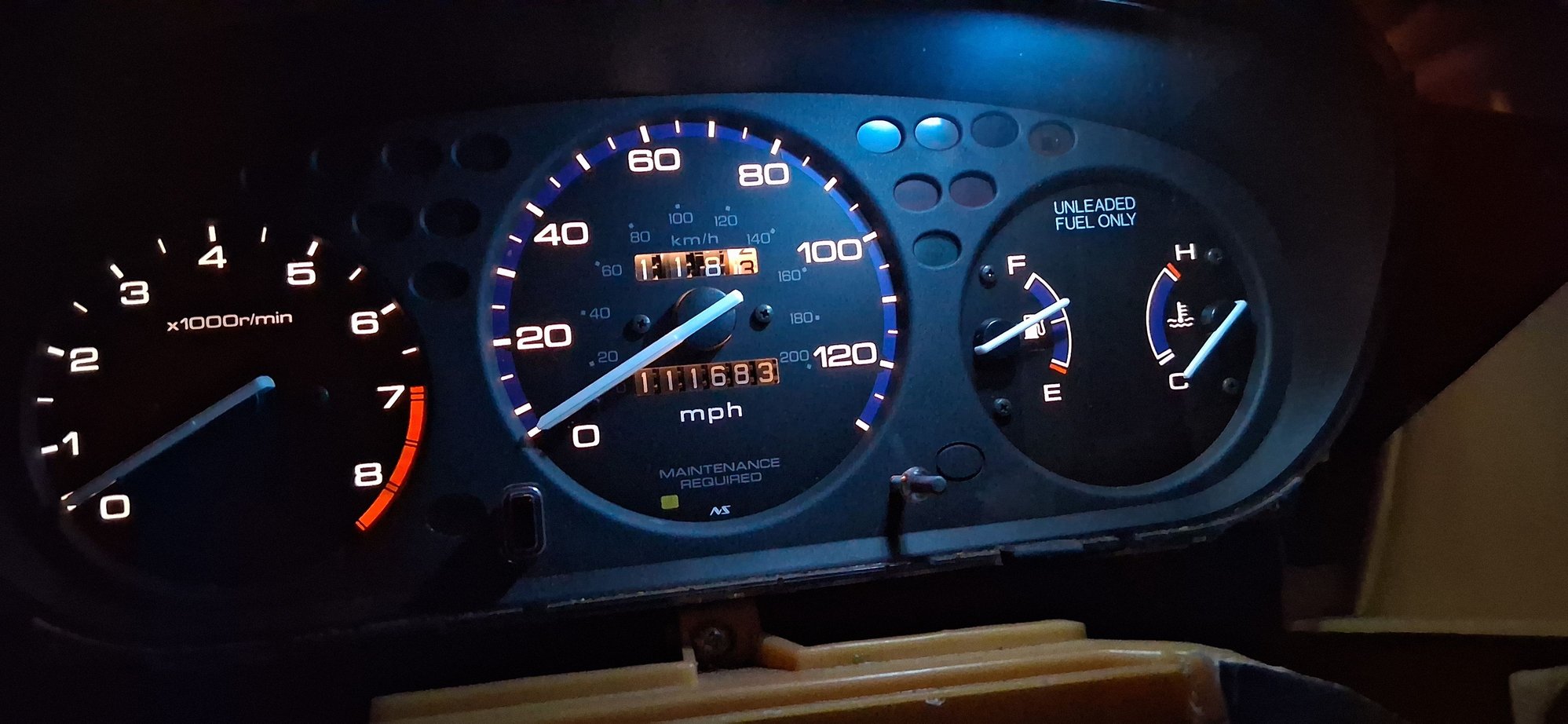

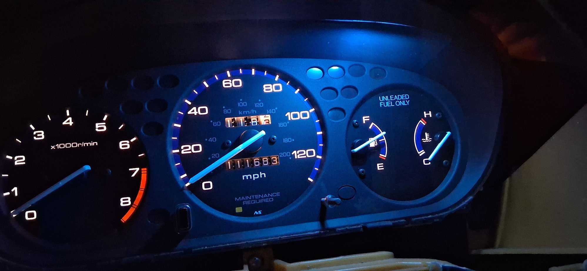

LED's for the Cluster
Simple replacement trying to find a color scheme and orientation I like. Unfortunately the layout of the cluster bulbs are weird resulting in some bleed from other sections of the cluster.
My Color Scheme at the moment. x1 194 Red, x1 74 Red, x1 74 Cool White, x1 74 Warm White, x1 74 Blue
^^My Color Scheme at the moment. x1 194 Red, x1 74 Red, x1 74 Cool White, x1 74 Warm White, x1 74 Blue^^
Cool White 74
^^Cool White 74^^
Natural White 74
^^Natural White 74^^
Warm White 74
^^Warm White 74^^
Amber 74
^^Amber 74^^
Red 74
^^Red 74^^
Green 74
^^Green 74^^
Blue 74
^^Blue 74^^
